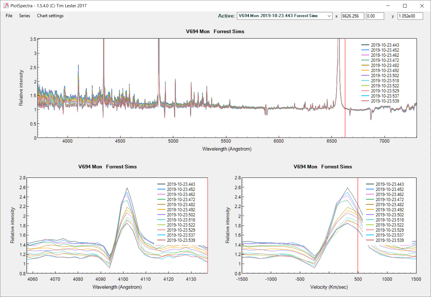

Hi Peter and Terry,
I was able to capture a sequence of spectra with my LISA of V694 Mon early morning before the HST window on the 23rd. I took 12 sequences of 7 images each starting with exposures of 120 seconds and ending with exposures of 80 seconds. Even so I still saturated Halpha in some of the sequence as the altitude increased and the sky brightened after astronomical dawn. Here are two PlotSpectra charts, the first one showing the 12 sequences with attention drawn to Hdelta at 4101.73 and the second one showing the PlotSpectra subplot for your HeI 4921.93 line. In the case of the Hdelta line, maybe there is some real change taking place over this several hour period. I suspect the general spread in the lines is due to having to choose one Reference star (therefore one Response curve) and apply it to all 12 sequences. But it still looks like there might be an amplitude change over time. And the other plot shows the HeI line Peter described but lower resolution than Peter's.
Woody Sims
v694mon_4922 subplot.png (49.47 KiB) Viewed 10420 times
