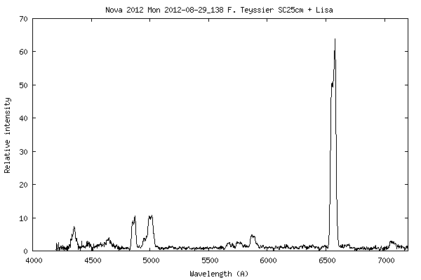

Re: Nova Monocerotis 2012
Spectre du 29 / 08 /2012
Note aux observateurs : cette nova mérite d'être suivie le plus longtemps possible.
Thank you for the comparison Ivan.
Here today spectrum. It becomes easier as the nova is higher (altitude between 24 and 31°)
[OIII] always strengthens.
Aras Pages updated http://www.astrosurf.com/aras/novae/TableauSpectres.htm

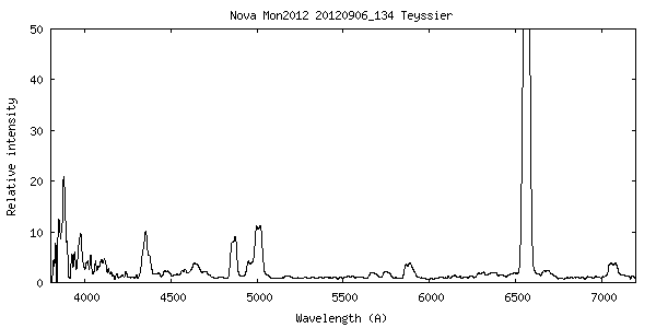

Nova Monocerotis 2012 - 07/09/2012
Observation of Nova Mon 2012 taken with LhiresIII 2400 l/mm on a Celestron 8 telescope:
Note: The LISA is equiped with a Atik460EX camera (bin 2x2) and the guiding camera is a Atik314L.
A view au the setup:
See also ARAS nova page: http://www.astrosurf.com/aras/novae/Nova2012Mon.html

Blue range and [Ne III] - N Mon 2012
Post by ivan degennaroaquino »
If you are curious and can push the blue wavelenght limit of the spectrograph, at 3869A the [Ne III] line emission is getting stronger. This confirms (again) it is a ONe nova.

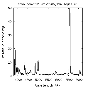

Thank you Ivan,
I have [Ne III] 3869 & 3968, but the spectrum is very noisy under 4000 angströms due to the poor sensibility of the CCD in near UV.
Here's a spctrum with a 5 sigma gaussian filter which shows [Ne III] 3869 & 3968
Kind regards
