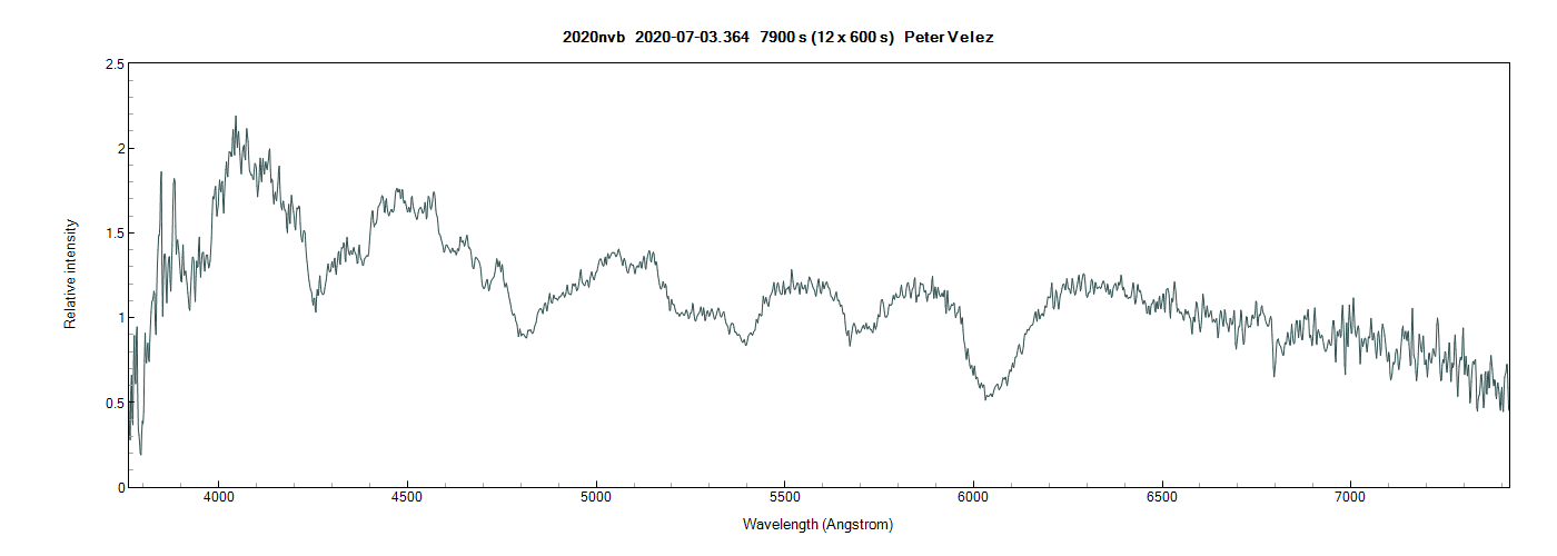

I managed to collect 2 hours of data on this SN last night.
Here is the spectrum produced with PlotSpectra. I'm still learning how to annotate and measure with the program.
Matched with Gelato to a Type 1A SN - best fit is 2003du 9.9 days before maximum. However the next nearest best fit is to 1992A only 5 days before maximum so I am not confident on the time to maximum yet. The response curve is a bit ropey as I used a reference star at the beginning of the imaging run so it drifted over the 2 hours. Gelato plot is also attached.
Its reported to have a Si II velocity of 12,500 km/s which matches nicely with the dip at 6031A in my data.
https://wis-tns.weizmann.ac.il/astronot ... e/2020-130
Lastly, I attach a screenshot taken with my guider. The SN is quite bright and I needed to tweak the contrast to tease it out from the galaxy.
Looks like I have a target for the next week or 2 to play with.
Pete
Re: at2020nvb a bright transient in NGC4457
Excellent !
If you like you could sign up to the BAA spectroscopy database and add your spectra there. (You do not need to be a BAA member)
https://britastro.org/specdb/index.php
(You will see all my spectra including supernovae there)
Or if you post the 1D fits or dat file here (as a zip file so the forum accepts it)
I could run it through SNID for you which might give a better estimate of age
Thanks Peter,
SNID suggests -1.3 days from max but with an uncertainty of +-4.8 days. (Itagaki first spotted it at 15.5 mag C on 2020/06/24.50 )
I see there are now two spectra on TNS, the earliest one is by the Italian amateur team also using an ALPY600 but the professionals reported first so get the credit for the classification even though they did not publish their spectrum at first :(
