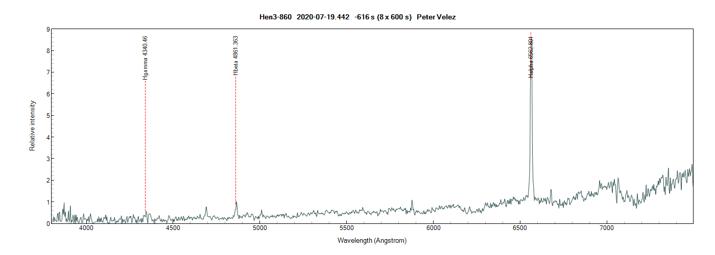

Posts: 153
Post by Peter Velez »
Here is my spectrum for Hen 3-860 from 19 July.
Its quite noisy - the target is faint and the conditions were only so so. That said, the H alpha and H beta emissions are quite plain to see. There are a few other emissions that I am unsure about. I confirmed this with a second set of images on 20 July. I will give this some more time over the next week when the weather is better
Francois, I will send the .fit file to you by email
Pete
Posts: 1565
Hi Peter,
That's a great result on a very faint target. Congratulations.
Your spectrum clearly identify Hen 3-860 as a symbiotic star:
- continuum of the red giant
- Balmer (HI) lines and high ionisation lines : He II 4686, [OIII] 5007
There are also He I lines 5876 and 6678.
You can find information in http://www.astronomie-amateur.fr/Docume ... _2017.ppsx
All the best!
Jaroslav Merc

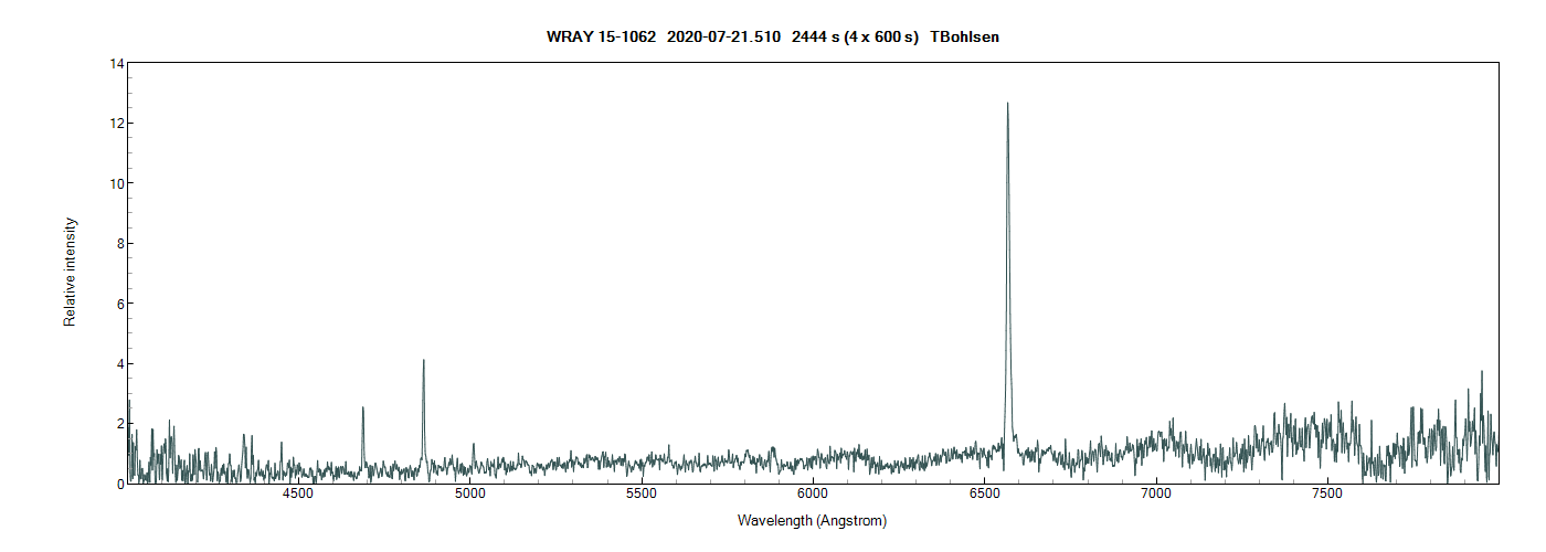

Terry Bohlsen
Posts: 191
Post by Terry Bohlsen »
Hi
I have also taken a spectra of Hen 3-860 or WRAY 15-1062 as it came up on Simbad.
It is clearly a symbiotic star.
Terry
Terry Bohlsen
Armidale NSW
Australia

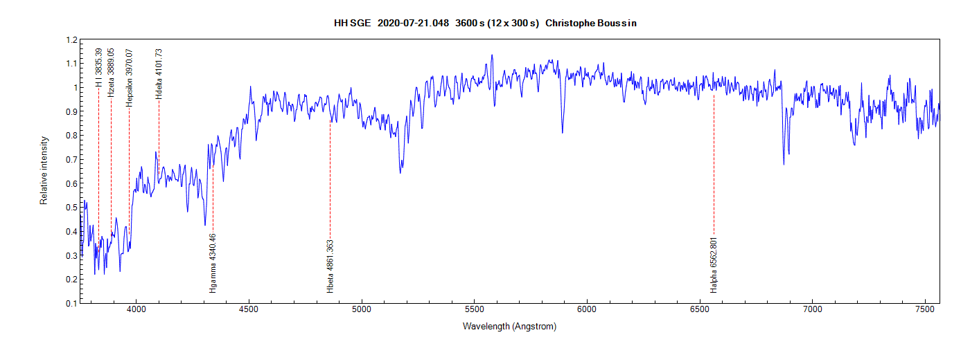

Posts: 172
Post by Christophe Boussin »
Congratulations Peter !
Here is my second contribution to the suspected/misclassified symbiotic stars.
I obtained the following spectrum of HH Sge with a spectral range including the Halpha line (from 3750 to 7565 A) the 21th of July at 01 h 08 TU with my Alpy 600 (resolution of 502, JJ = 2459051.5477) and an acquisition time of 60 min :
HH Sge on July 21th, 2020 (3750-7565 A)
_hhsge_20200721_048_Christophe Boussin_3750_7565.png (127.74 KiB) Viewed 211878 times
Identification of Balmer lines from PlotSpectra :
HH Sge on July 21th 2020 (identification of Balmer lines from PlotSpectra)
Clear skies,

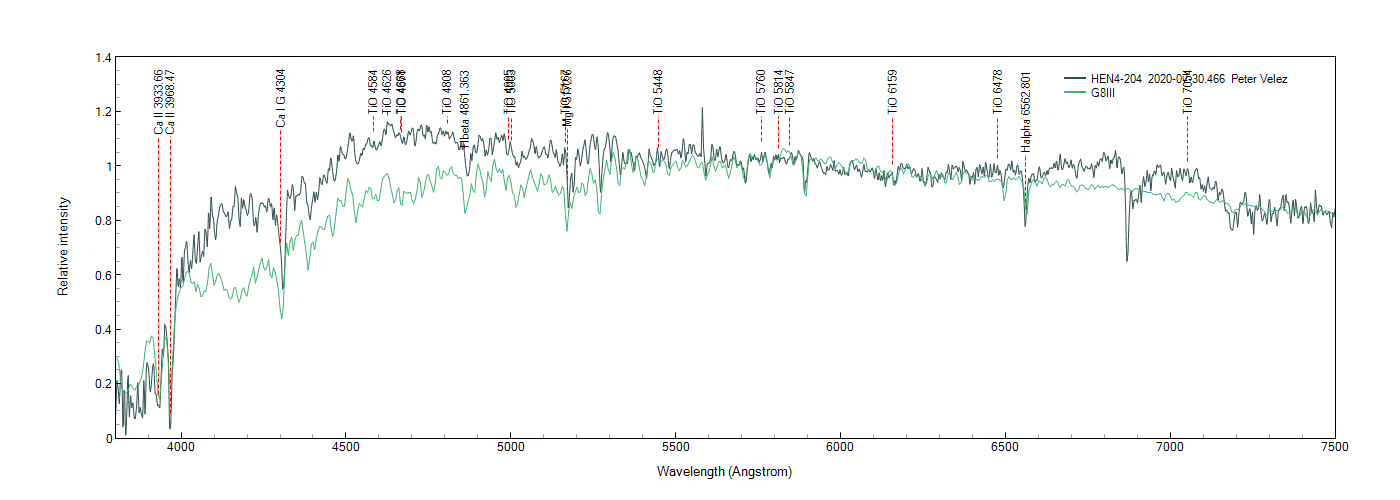

Peter Velez
Posts: 153
I confirmed my earlier results for EC 19249-7343 and Hen 4-204. Both are not symbiotics.
EC 19249-7343 looks a good match for an early M giant. I've attached my spectrum plotted against a Pickles M3III synthetic spectrum with a few absorption lines noted.
Hen 3-204 seems to be a mid G giant. My spectrum is plotted against a G5III synthetic spectrum. The spike at 5581A is spurious.
Spectral calibration in the UV/Blue is not great - but should be sufficient for present purposes.
Pete
