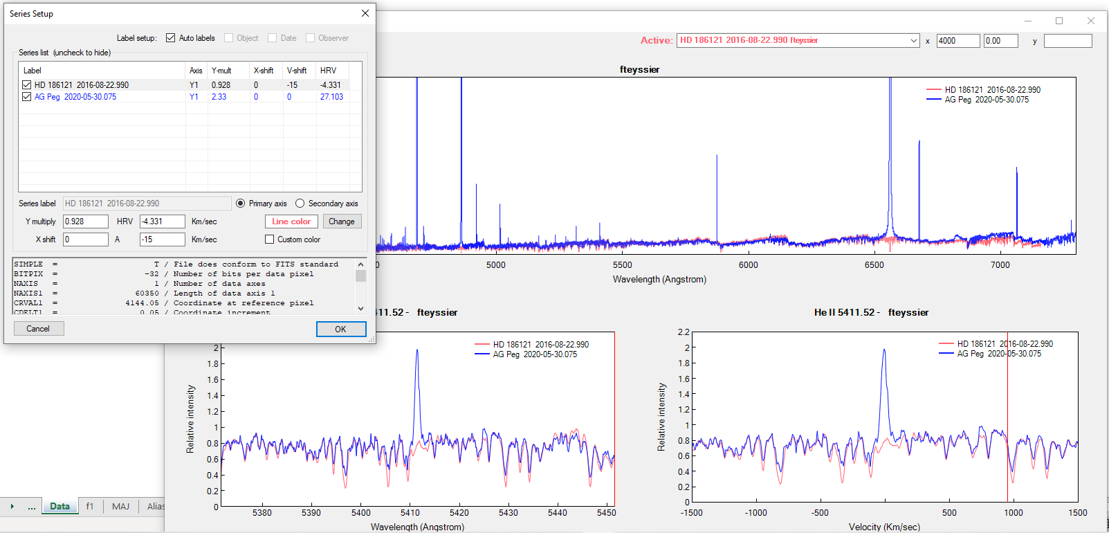

in the Series Setup dialogue am I right to think that HRV allows for a heliocentric correction to be added manually ?
and what is the "A" box for below HRV which seems also to have a Km/sec scale?
thanks
gavin
Posts: 1955
Re: PlotSpectra
Hi Gavin,
I think the bottom two boxes refer to the X shift, either in A(ngstrom) or km/s
Not sure why the HRV box is also there though (It appears to do the same as the X shift in km/s) unless it is designed to pick up the Heliocentric correction from the fits header perhaps, or alternatively the heliocentric correction can be entered and then an additional RV shift applied using the two boxes (figures entered into both boxes produce a cumulative shift in the spectrum)

Posts: 1557
Re: PlotSpectra
Hi Gavin,
I confirm Robin's answer.
The HRV is extracted from the header.
The change of HRV and X-Shift values have the same effect.
Here's an example
The comparison of AG Peg and HD186121, a M2III normal giant
Both have been corrected for HRV
I have shift the HD186121 spectrum by -15 km/s (X-shift) in order that the absorption lines matches with those of the continuum of AG Peg.
This avoid confusion, keeping HRV values.
Plotspectra works very well with echelle spectra.
Best,
