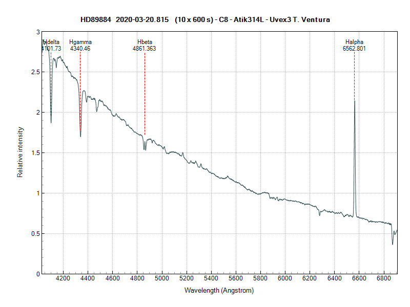

In these difficult times, the only entertainment we can afford is observation. The last spectrum that I have elaborated is the star HD89884. It is, as always, a Be star whose obtained profile has an R = 807 and a dispersion of about 4.16 A / pixel. Simbad gives for this star a magnitude V = 7.13. While the spectral class turns out to be a B5III, therefore a giant of class B. It is interesting to note the double absorption on the line of the Habeta that the harvested instrument.
Regards
Tonino
hd89884_20200320_815_Tonino Ventura.png (31.93 KiB) Viewed 8244 times
