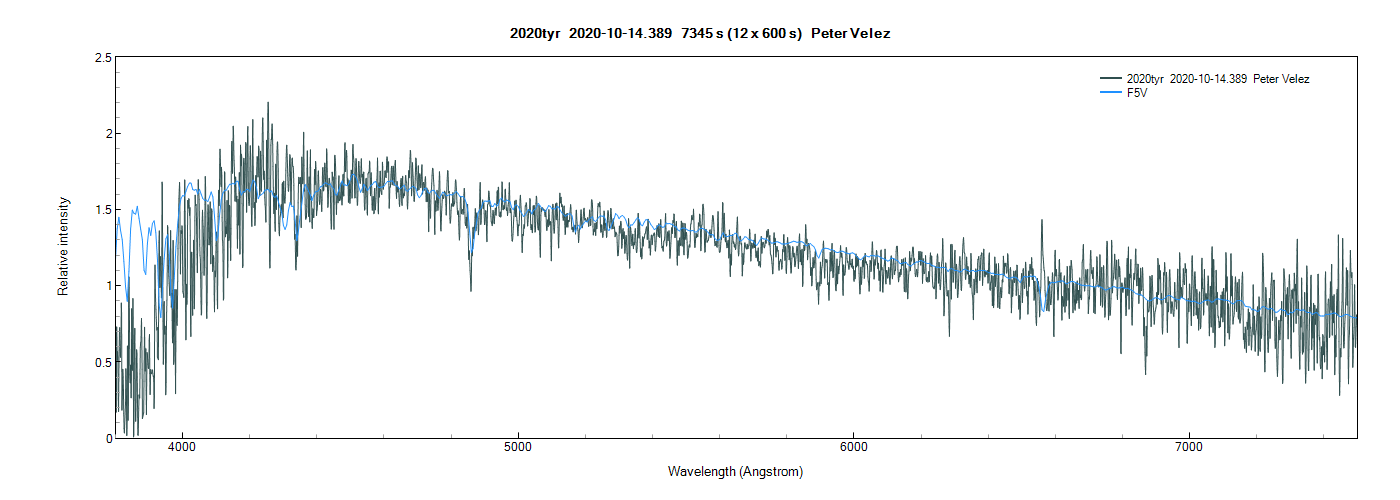

Here is my spectrum from last week in all its ugliness.
I've added a synthetic F5V spectrum for comparison. Looks a reasonable match to me.

Great one peter. Not ugly! I think it is interesting that the F-G type spectral trend seems consistent with what I posted. Is that a little emission at H-alpha? Given the noise, H beta and gamma could well also be hidden in there.

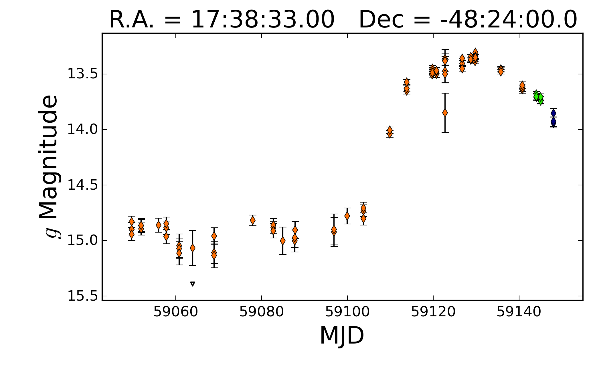

Latest asas-sn light curve included above. If it is a nova then I guess emission lines should get more obvious.

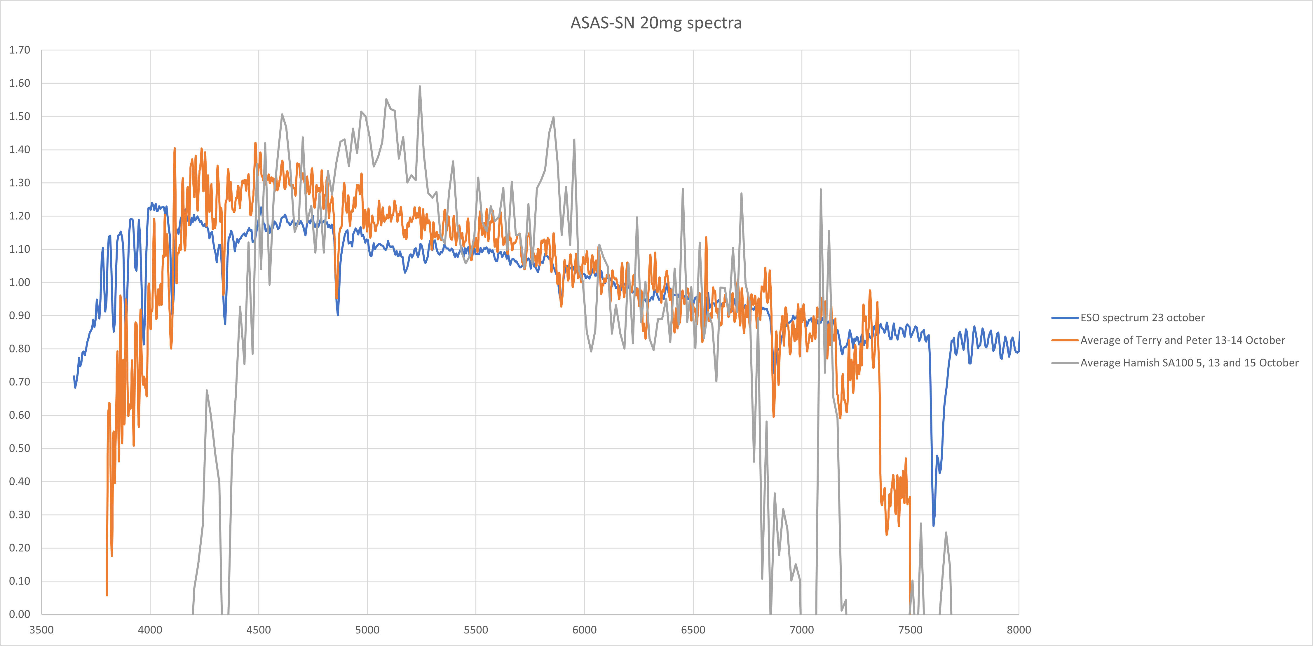

Someone finally put a 2m telescope onto the job and posted classification of CV on23 October.

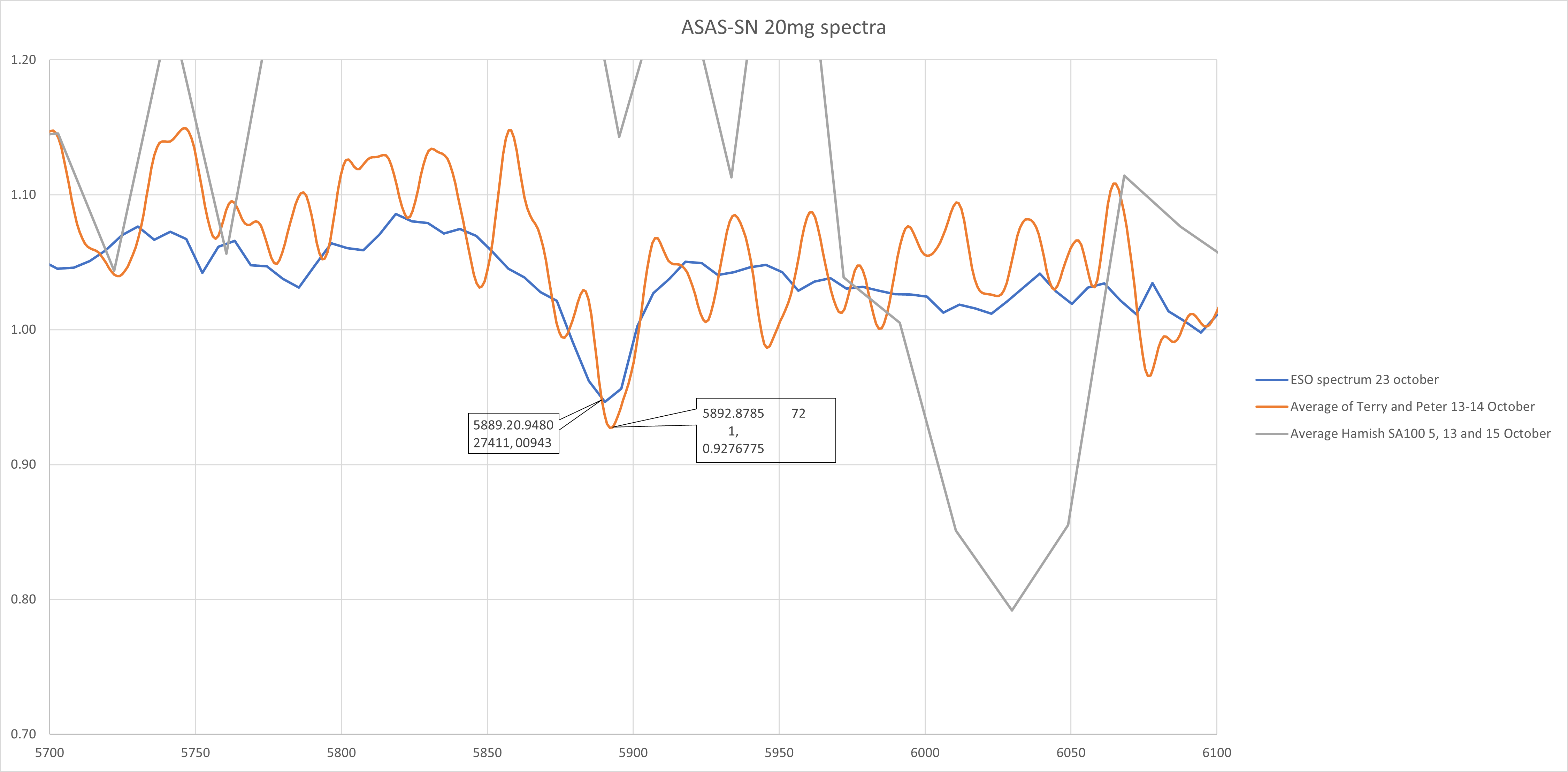

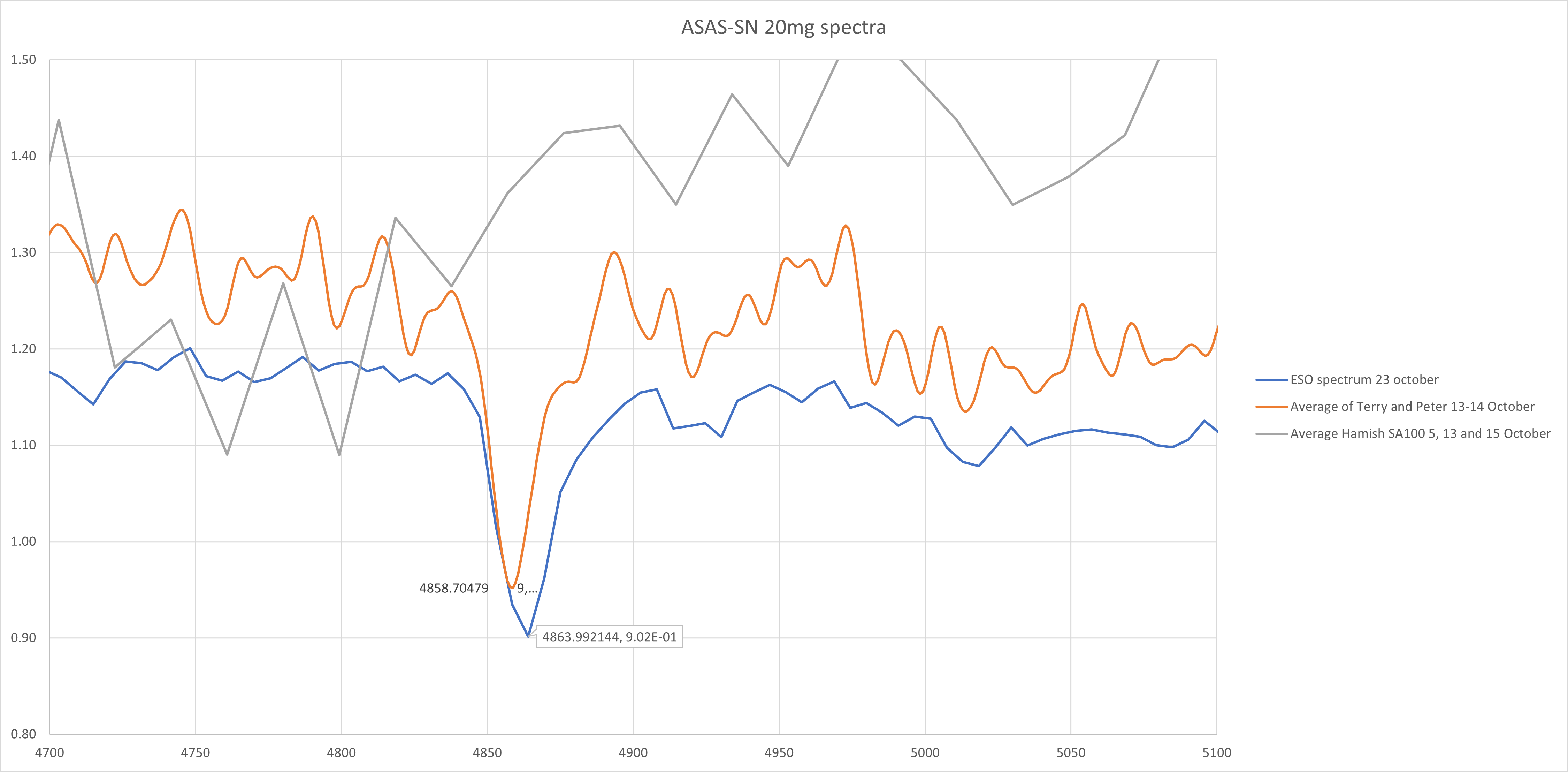

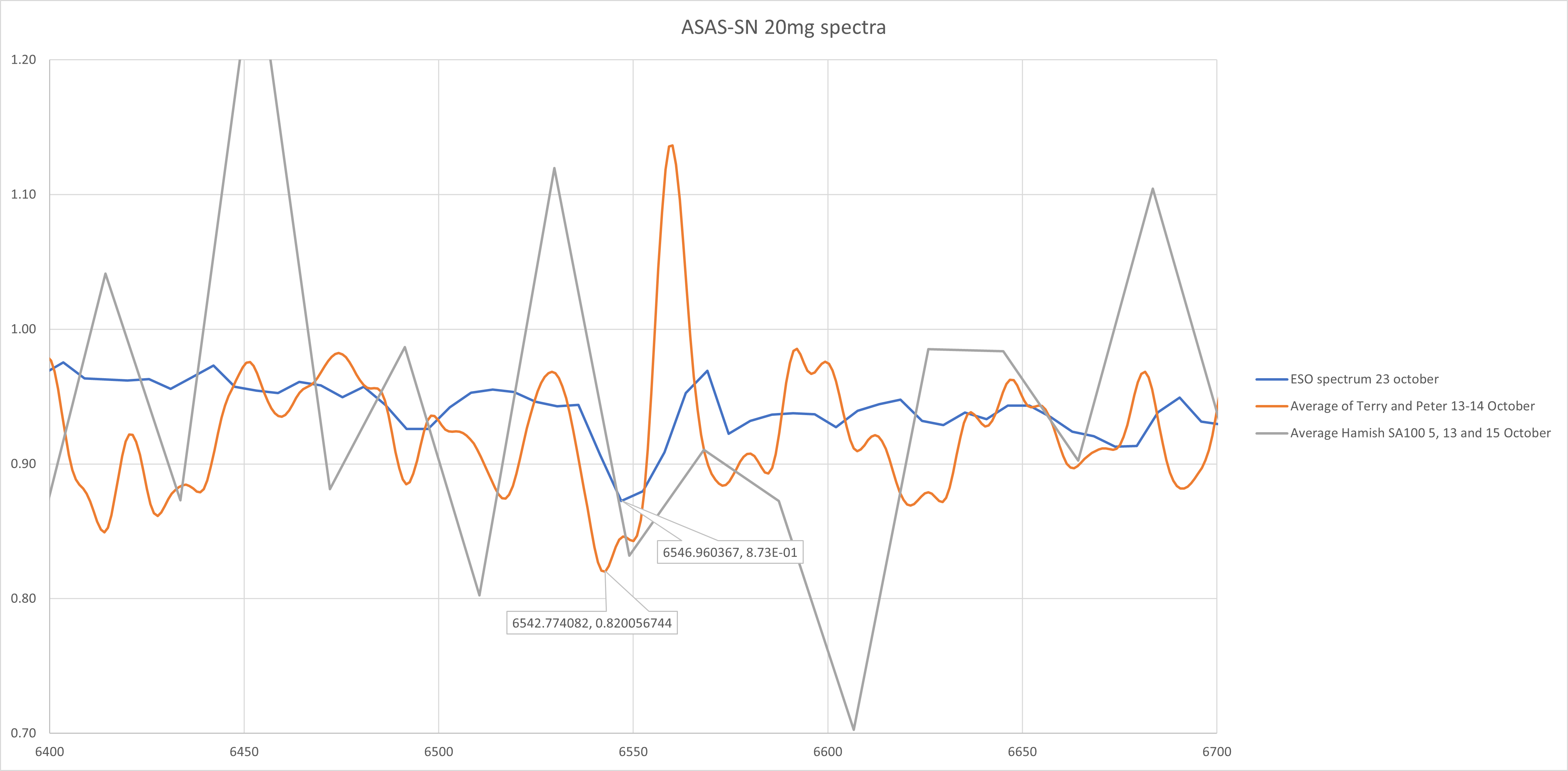

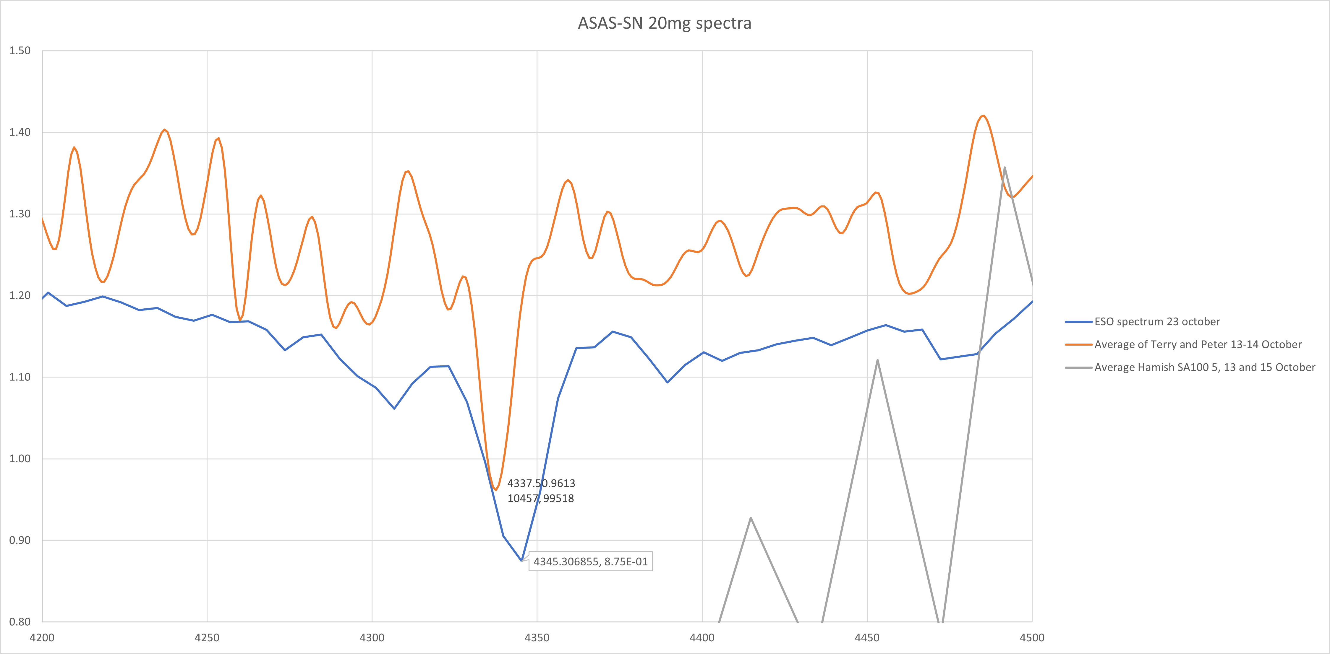

I combined Terry and Peter's spectra (note observations were different by a day) to reduce the noise a bit and overlaid the ESO spectrum from 23 October and my crappy SA100 .
I prepared an overall, and zooms on Halpha, beta, gamma and (maybe) sodium D regions.
anyone with CV expertise? Are they normally hotter than the apparent continuum slope seems to indicate in Terry and Peter's observations of around 6000K?
Hamish
