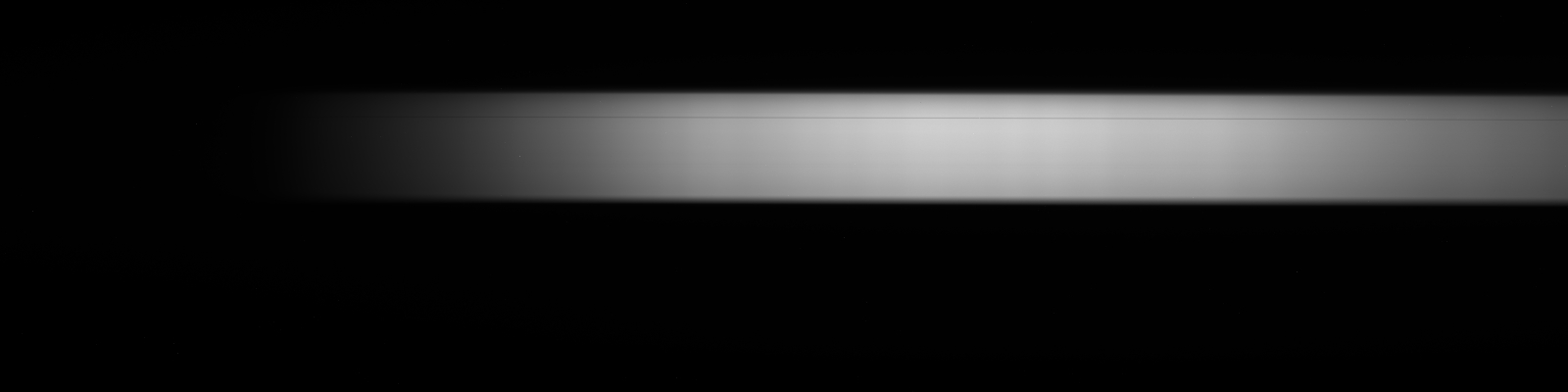

I am starting again with Spectroscopy with my LISA and have a question in regard to correct exposure time for the Master FLAT for calibration.
I have the FLAT / NEON accessory. Below the FLAT I am using but I have the feeling like the center part is to bright :?:
I am using a QSI 520i in binning X1 x Y3 and it has a 7.4 micron pixel and CCD KAI-2020 and 40.000 e full well
I do all my preprocessing using PixInsight eg. applying BIAS, DARK and FLAT to my images. I stack up to 20 images ofor each Master spectrum.
Thanks for any tips

For a good flat, you need to take let say 30 flats with a dynamic around 2/3 of the range of your sensor.
With your CCD (16 bits) you have a maximum of 65536 ADU.
With my own experience, I take 30 facts around 50000 ADU each. (see the copy screen below)
You will see that the flat level in the blue part of the spectrum is very low, so, that's why you need to take many flat. (to increase SNR in the blue part)
You can check the ADU level with you acquisition software (here it's Maxim DL, but you can of course use others softwares.)
After for processing spectra, it's necessary to use only one software for the whole process like Demetra, ISIS, Vspec, spcaudace, bass for example...
Do not use a binning 1x3 that could be a problem during the process if your spectrum wide is around 2 pixels...
Hi Olivier,
Thank you very much for the explanation.
I made 20 FLATS and stacked them. The attached image of the FLAT is a 20 image stack in Pixinsight. Will test with 30 and as you said 2/3 ADU.

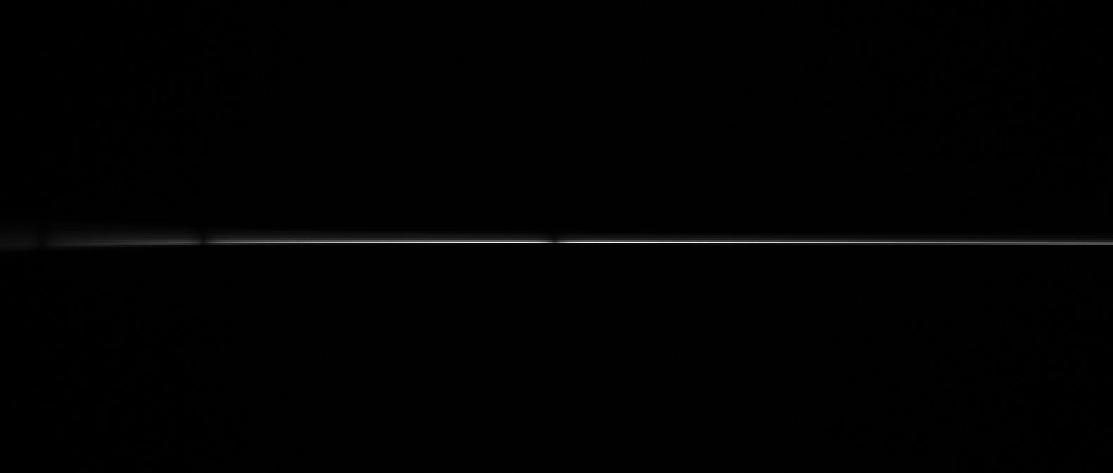

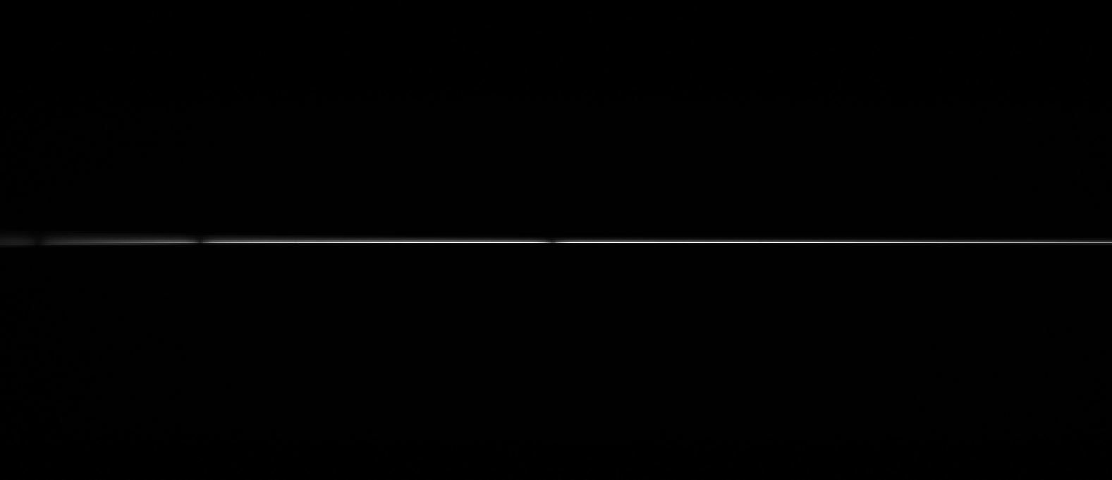

In regard to above I made a little test and took the same Object in binning 1x, 2x and 3x and I see no difference in the width of my spectrum.
You comment helped me to better align my camera to the spectrum. Thanks.
See attached images.

I had a window between the clouds and was able to get Vega into LISA and made same 1 second exposure for each.
For better view I resized it. This is the result from top to bottom 1x, 2x and 3x
here from this link you can download the 3 fit images for comparison if you like.
https://rainerehlert.com/000_LISA/
Thanks and regards Rainer
Re: LISA and correct FLAT image for calibration
Your spectra look good and the binning mode is ok in Y axis.
For my own opinion, it's better to use the bin 1x1 mode because when you process your spectrum, you have to define a binning area and if this binning area is too thin, you may have a problem with the result.
