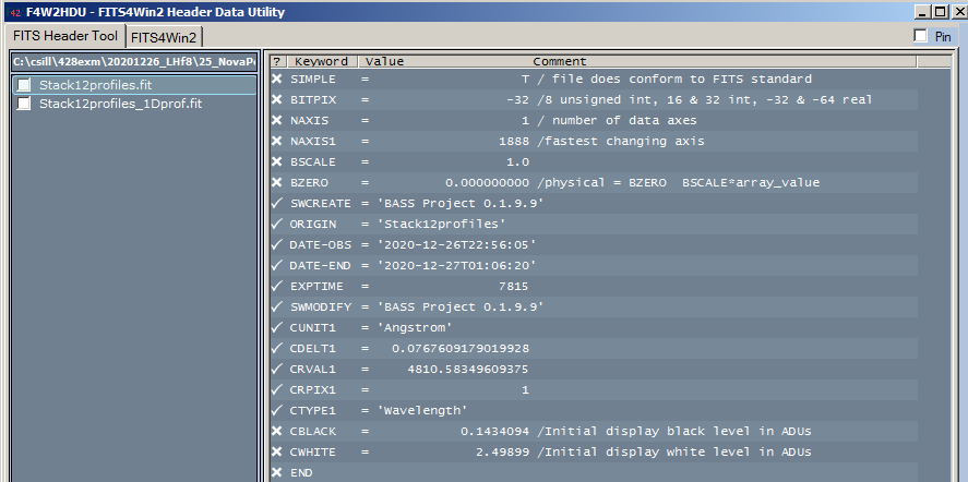

I've read the BaSS manual and installed the latest beta now, and found facility to stack 1D profiles (Operation -> "Stack and Align profiles"), but unfortunately always getting an error message "All the profiles must have the same width" even when I manually crop them either in ISIS or the BaSS X-Axis (input: N times 1D spetrca processed with ISIS). I stop my effort in this direction for now, maybe I continue later.

Trying SpectroCalc/1D Wizard (for fits header generation purpose), it also complained of different wavelength regions coming from ISIS as an input, similarily to BaSS.
For this particular problem, found a workaround in ISIS: subtracting zero fits (generated from 1st spectrum by subtracting itself - that preserves its header very well) from each spectra as a serie (1 mouse click). The output 1D sequence can be fed now for both SpectroCalc and BaSS.
However, its sum via SpectroCalc doesn't contain any essential header data (e.g. DATE-OBS).
Trying again the already mentioned Bass/Operation->Stack and/or align profiles (now it works!), the generated sum only partially preserves the following fields:
I believe this is not enough.
