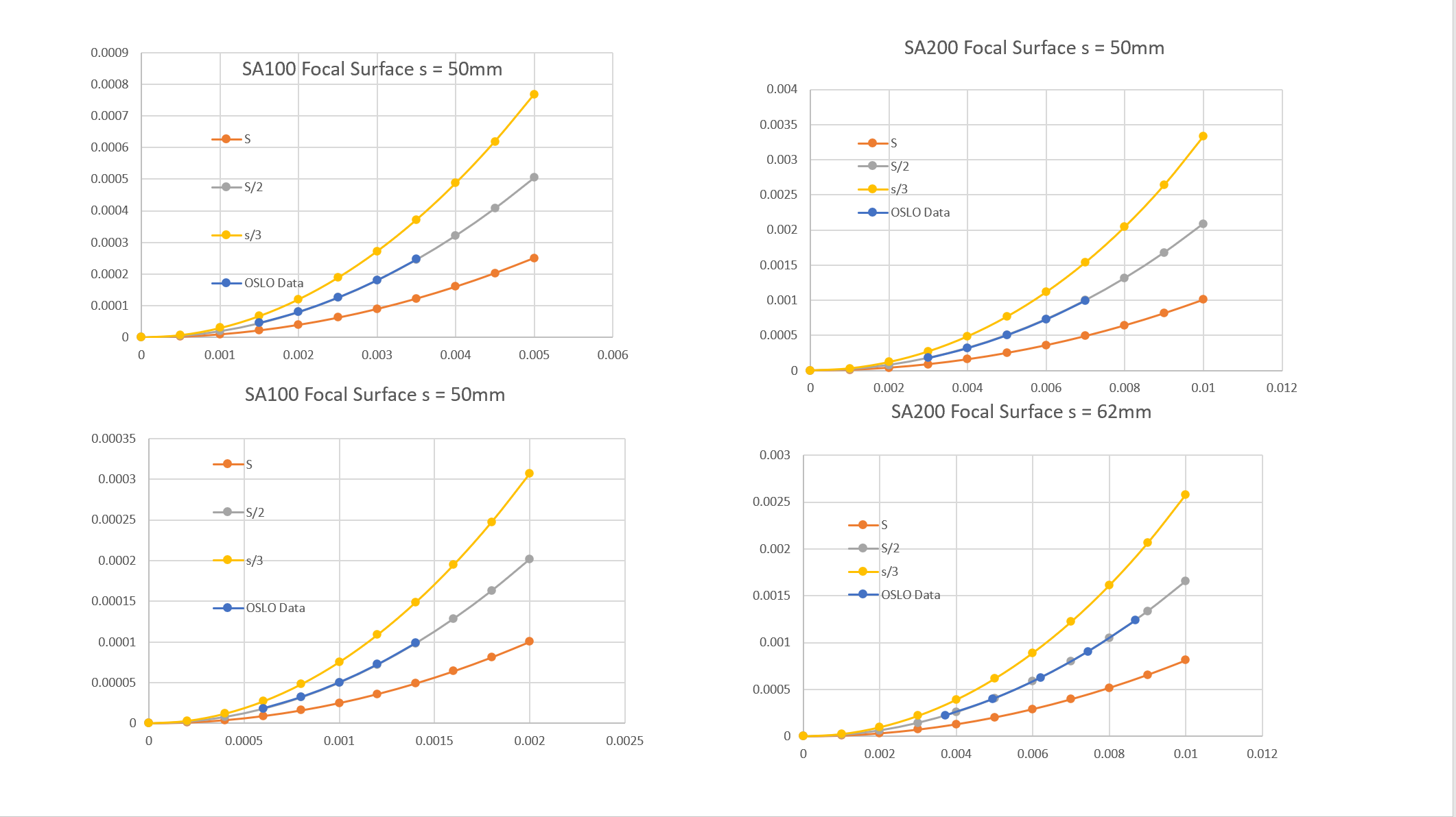

I used OSLO Edu to experiment with a 400mm F6.8 parabola on axis and a grating with 100 or 200 l/mm with various spacings. To get the surface of best focus as a function of wavelength I performed a monochromatic optimisation of focus minimising the OPD (optical path difference) one wavelength at a time. The OSLO data is from 3000A to 7000A
The best focus lay between the two curve with radii s and S/3 and surprisingly fell on s/2 in all cases.
Any comments or explanations would be most welcome. There is always the possibility I made a mistake but I did check my trigonometry.
