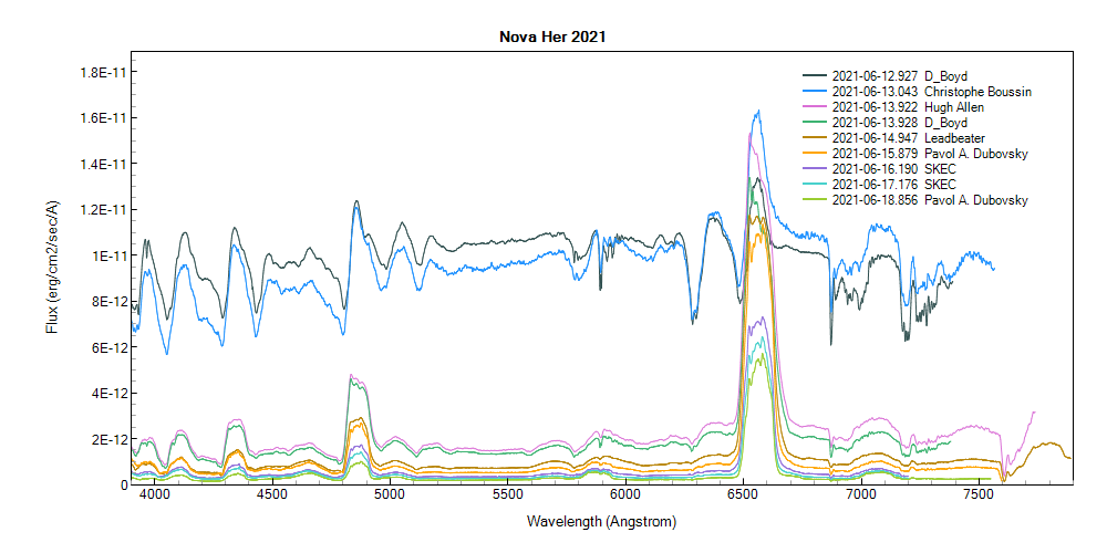

Here is a plot showing the evolution of the nova over the period 12-18 June using low resolution (R~500-1000) spectra from the ARAS database calibrated in absolute flux either by the observer or using V mags from the AAVSO database averaged in quarter day bins and interpolated to the times of the spectra.
Nova Her 2021 12 - 18 June.png (97.17 KiB) Viewed 13938 times

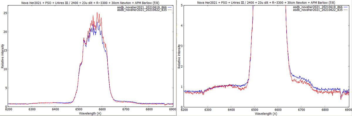

Your titles say 2400 grating and R~3300. Is this correct (600 grating?)
Re: Probable nova in Hercules mag 6.4 !
Robin Leadbeater wrote: Your titles say 2400 grating and R~3300. Is this correct (600 grating?)
Sorry, I've overlooked an old value in ISIS -> Gnuplot -> double plot (has to be filled manually), should have been 600/mm grating.
The .fit headers are correct.
