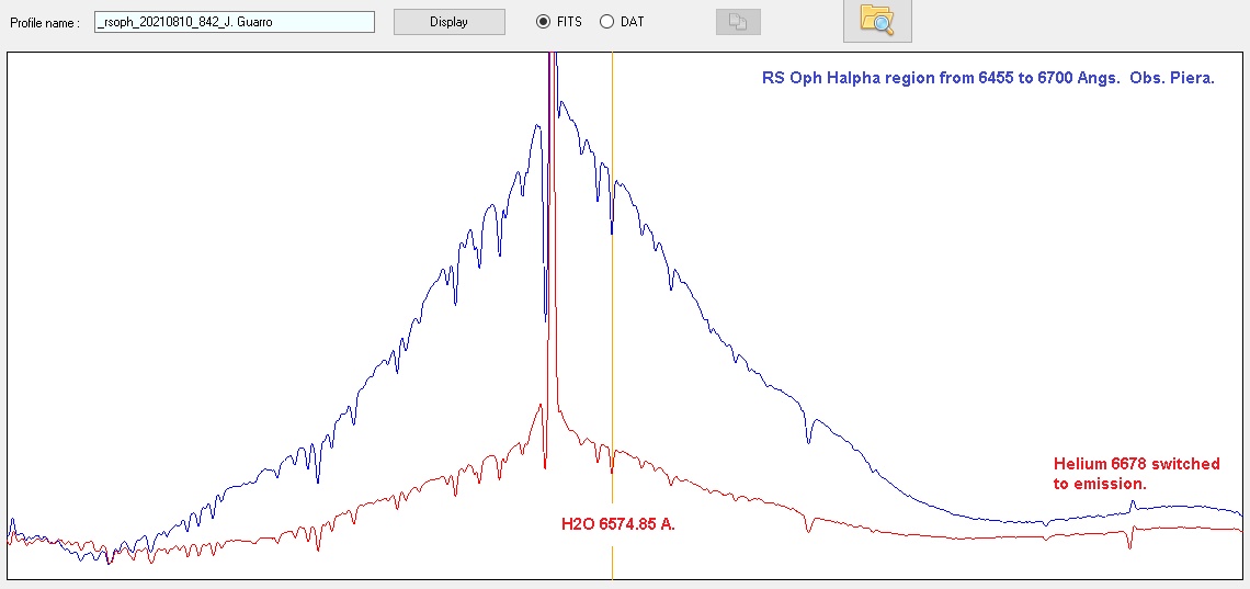

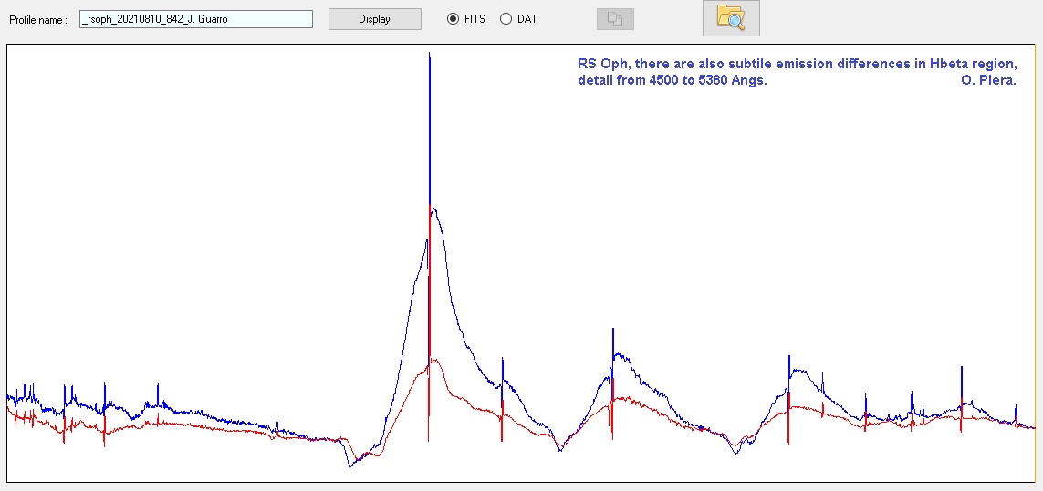

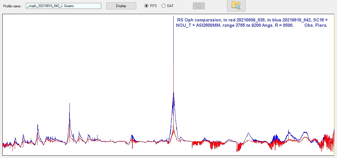

Those are some graphics from Piera, with a SC16 + NOU_T echelle + ASI2600MM camera.
Regards, J.Guarro.

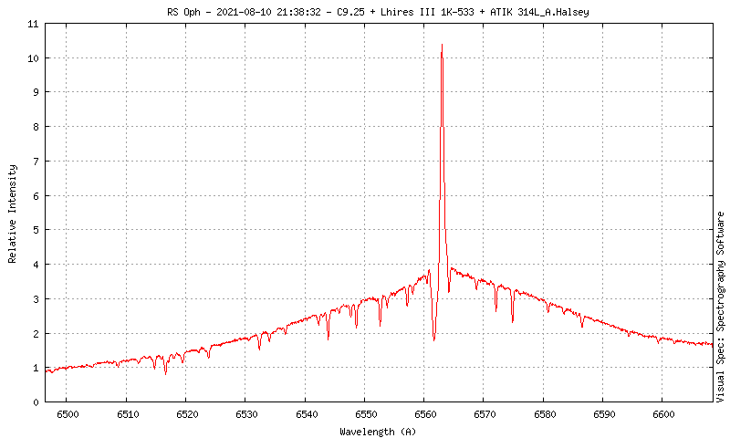

Post by Alun Halsey »
My attempt last night (10th) using my C9.25 and Lhires III with 23m slit riding on a CEM60,captured 9x60sec images. I chose Vega as reference star,and RS Oph profile normalized at wavelength 6498 to 6503. Used ISIS to carry out calibration and Vspec to create chart.
_rsoph_20210810_902_alun halsey.png (7.27 KiB) Viewed 83407 times

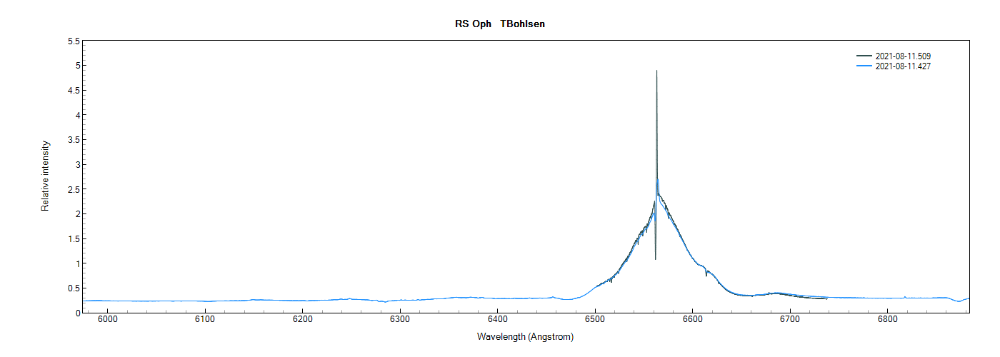

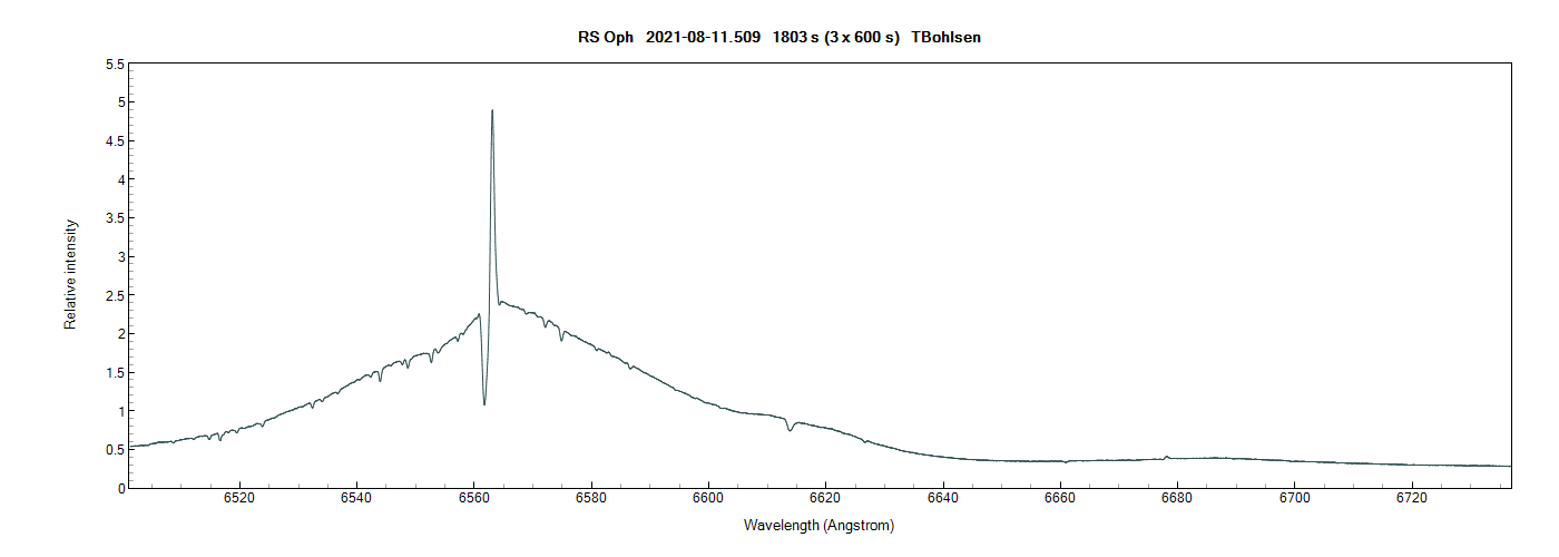

Post by Terry Bohlsen »
Hi All
This is my effort from last night.
I used my LOSPEC at R=~4700 and my LHIRES R=16000.
Interesting to see the difference that the resolution makes.
Terry
