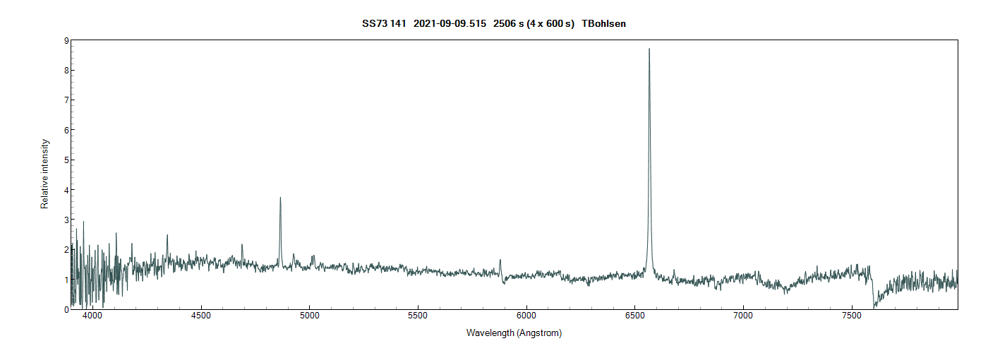

I took a spectrum of this target last night using my LISA R=1600.
Terry
