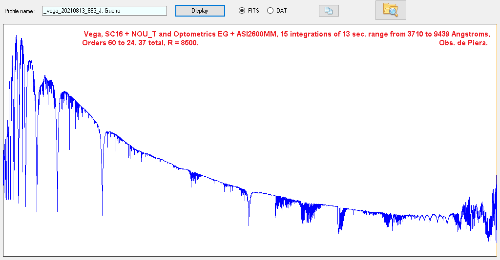

- Posts: 700
Hello at all,
You Know that Thorlabs is a serious brand of optical components and almost all of us have used their products for our spectrographs. I have used too their echelle gratings for all my echelles, MUSSOL, LINX and the two NOU_T that I'm using now, each in Pieraother in Santa Maria, (SMM).
Last February/March, I read in FVDS one topic over "Efficiency of Thorlabs echelle gratings", started by Tobias Feger on 23th October 2015, lord! Because I didn't read it before !! It seems echelle gratings from Thorlabs are really the most precarious ones in the world.
https://forum.vdsastro.de/viewtopic.php?f=2&t=4371
Years ago I sometimes bought gratings from Optometrics, so I bought them an echelle grating, and two months ago I mounted it in a NOU_T that I sended to an observer.
Of course, before I tested the NOU_T and noticed the Optometrics EC was twice more efficient than Thorlabs one ! Using a ATIK460EX 18000e-/pixel.
So I bought another one from Optometrics but I have waited one month for it because they are out of stock. Finally I tested this last Optometrics Echelle Grating in the PieraNOU_T with the ASI2600MM 50000e-/pixel, the efficiency is around 50%, similar as thefirst test.
But the behavior of both Optometrics EG there are different, the blaze angle isn't the same, so the RELCO ( tungstene ) points map is displaced.
The latest news is that Edmund Optics has started to sell Richardson EG, I'm going to buy one for the SMM NOU_T and I will see if Optometrics and Richardson have similar efficiency results.
You can see this Vega Graph, observation made between clouds and dust.
Cheers, J. Guarro.

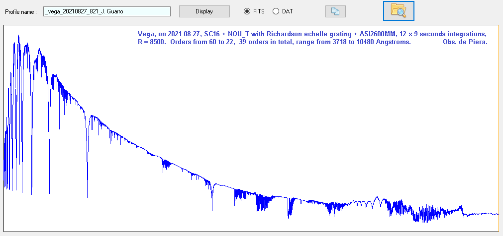

- Posts: 700
Hello at all:
Finally I have been able to test my Richardson grating with Vega. Almost all of us use this generous star to test our devices.
The Richardson EG hasn't disappointed its expectatives, it is around 50% better than the Optometrics one, and Optometrics is also around 50% better than Thorlalbs one so the Richardson is the best of the them with an efficiency 100% over Thorlabs EG.
Unfortunately I don't have quantitative data about that. I only expose here my observational results based on the detectivity and exposure times with the same telescope, NOU_T echelle and ASI2600MM camera.
But all it seems to indicate is that with the Richardson echelle grating my telescope mirror has twice the area than the Thorlabs one. In other words, my 40 cm. diameter virtually has passed at 55 cm.
Of course, without account the notable improvement is the change of the ATIK460EX to the ASI2600MM.
J.Guarro.
J.Guarro.
- VEGA+RIC.png (18.97 KiB) Viewed 15771 times

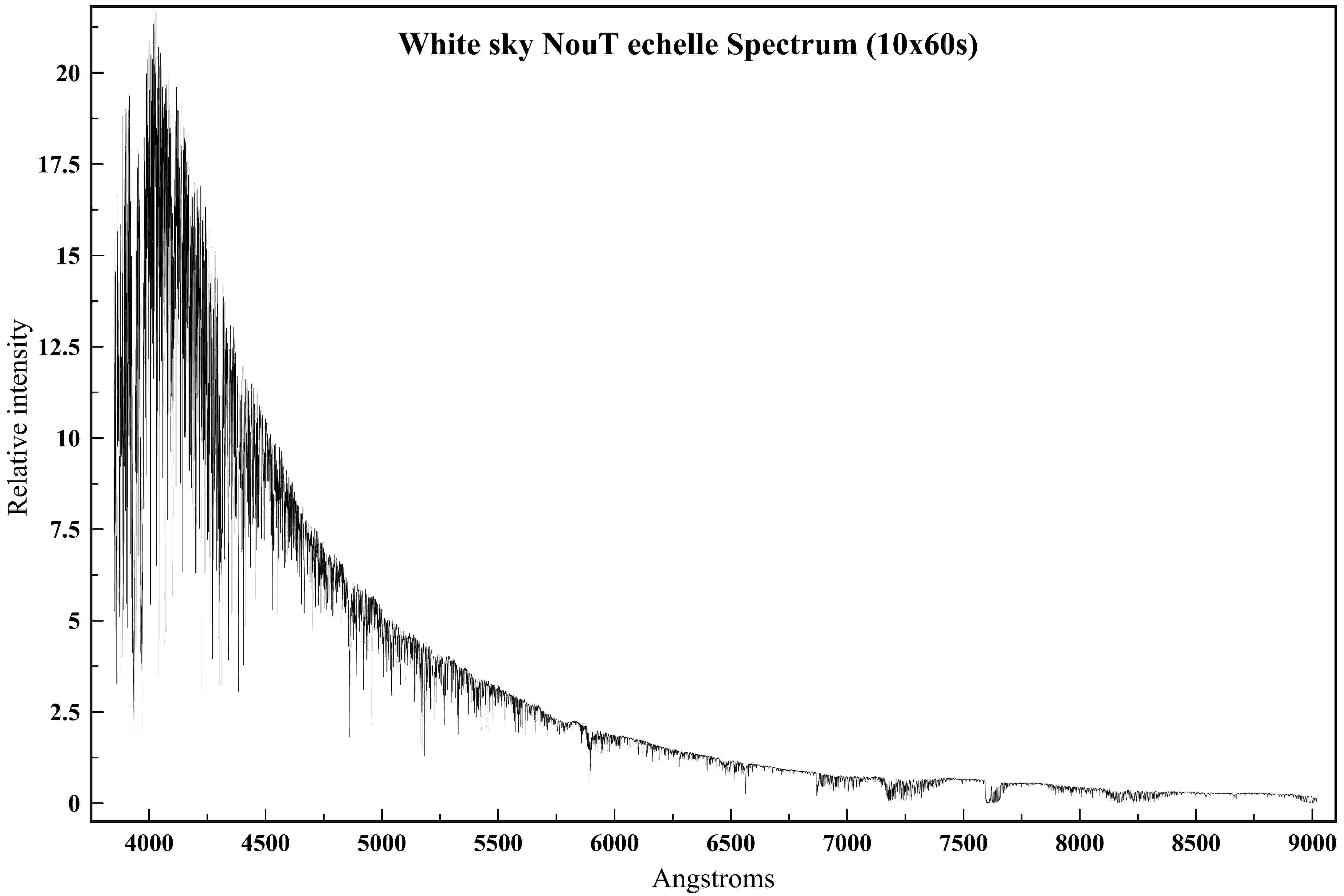

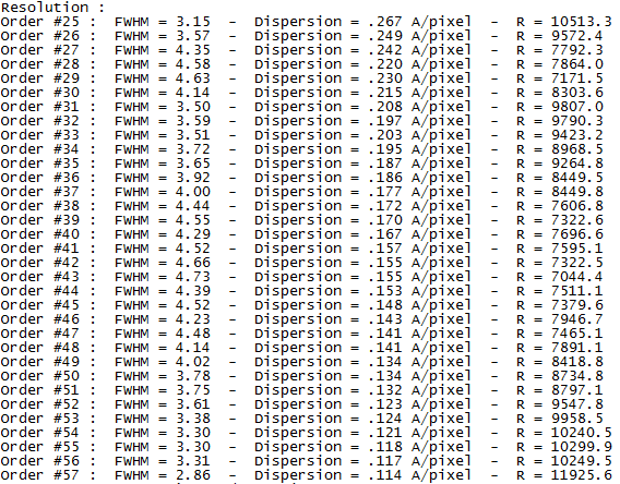

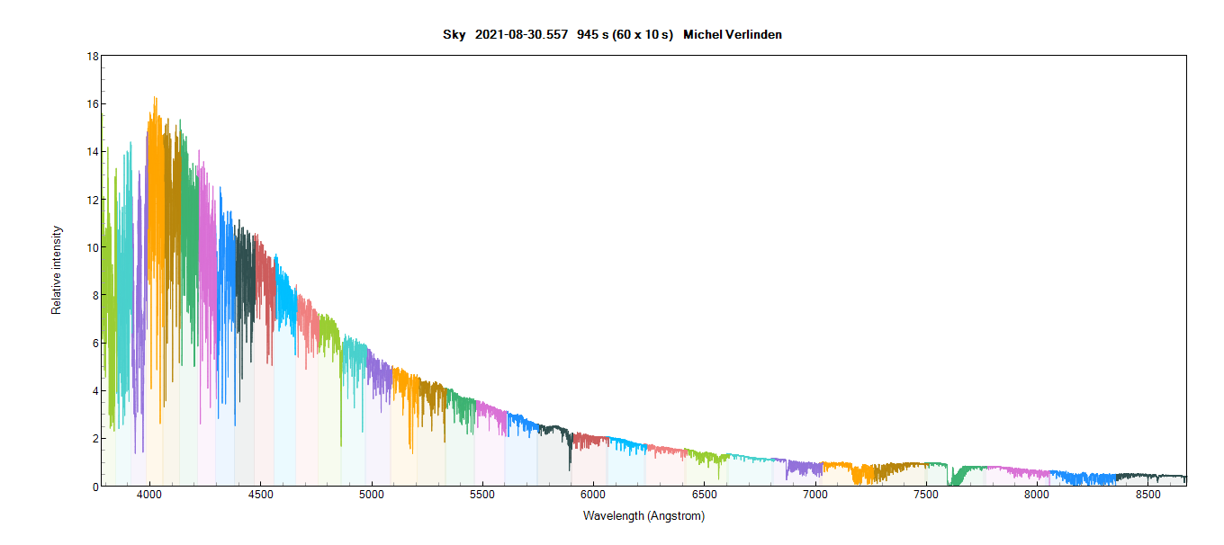

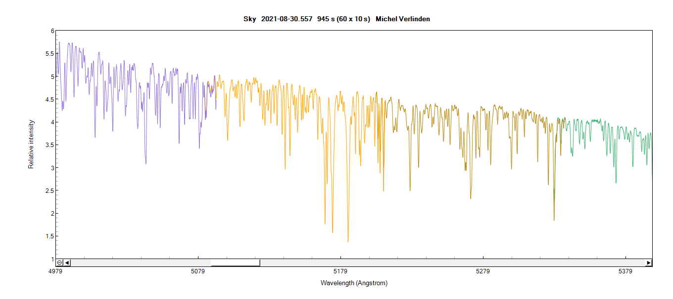

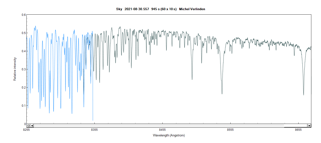

- Posts: 191
J'ai suivi de près les avancées du spectrographe NouT réalisés par Joan Guarro depuis presque un an. Au regard des tests présentés par Joan, j'ai décidé de le rejoindre dans sa démarche, avec l'idée d'apprendre le fonctionnement d'un spectrographe echelle, et d'aider humblement à l'amélioration de protocoles de réglage.
Je n'ai pas été deçu. L'instument est robuste (métal), stable thermiquement et les pièces mécaniques du NouT s'agencent parfaitement lors du montage. Joan m'a fourni une documentation pour le montage et les protocoles de réglage, et il m'a aussi beaucoup aidé par messagerie, faisant preuve d'une patience rare, un grand merci à lui. Les procédures de collimation ont été suivies et optimisées grâce à l'usage d'une caméra... Désormais, l'instrument est de mon point de vue assez simple à régler, mais m'a demandé un peu de temps au début (ce qui n'est pas vraiment une surprise lorsqu'on découvre).
Joan améliore constamment le NouT, actuellement il l'a modifié pour remplacer la caméra dédiée (une Atik460EX) par une ASI2600, vous avez du voir dans les précédents post l'élargissement du champs que cela permet et la récupération de plusieurs ordres dans l'UV et le NIR. Le changement du réseau (Richardson à la place de Thorlabs) lui a permis de gagner en rendement. Tous ces progrès sont spectaculaires et prometteurs.
I have closely followed the advances of the NouT spectrograph made by Joan Guarro for almost a year. In view of the tests presented by Joan, I decided to join him in his approach, with the idea of learning the operation of an echelle spectrograph, and humbly helping to improve tuning protocols.
I was not deceived. The instrument is robust (metal), thermally stable and the mechanical parts of the NouT fit together perfectly during assembly. Joan provided me with documentation for the assembly and tuning protocols, and he also helped me a lot by messaging, showing rare patience, a big Thank You to him. The collimation procedures were followed and optimized thanks to the use of a camera ... From my point of view, the instrument is now quite simple to adjust, but took a little time at the beginning (this which is not really a surprise when you discover).
Joan is constantly improving the NouT, currently he modified it to replace - the dedicated camera (an Atik460EX) by another, a zwo ASI2600, you must have seen that in the previous posts the widening of the captured field as a consequence, and the recovery of more orders in the UV and NIR. The change of the grating (Richardson instead of Thorlabs) allowed it to gain in efficiency. All of these advances are spectacular and promising.

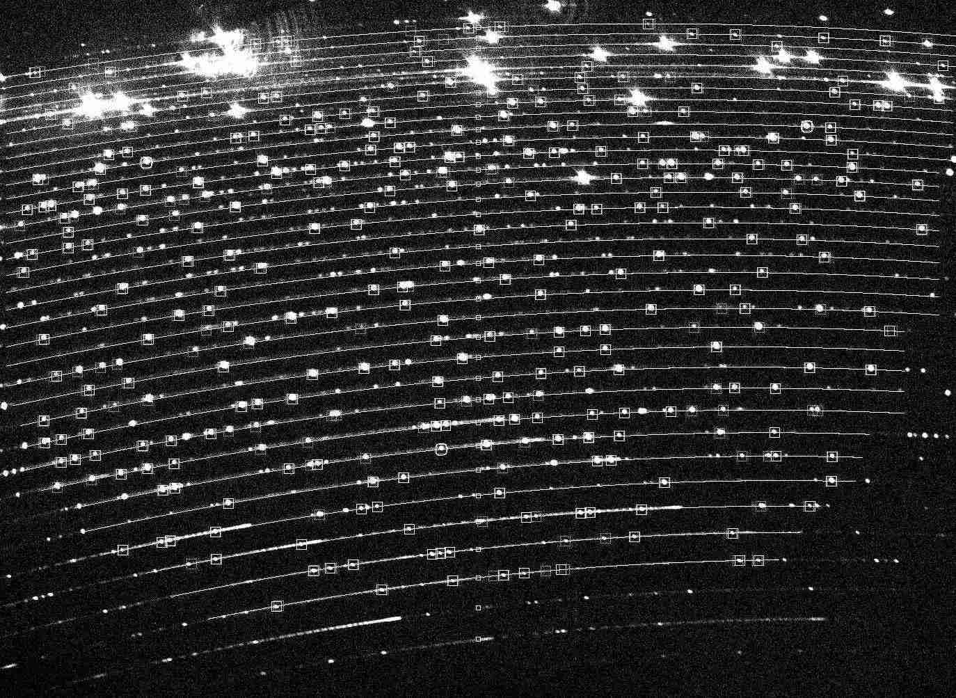

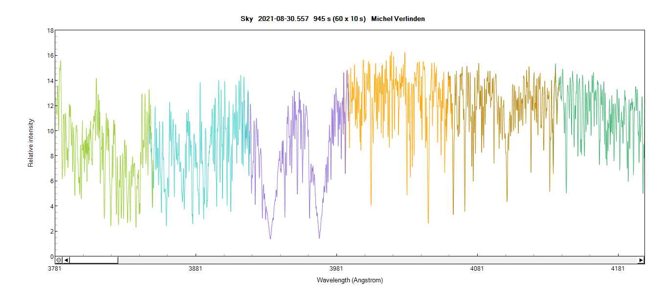

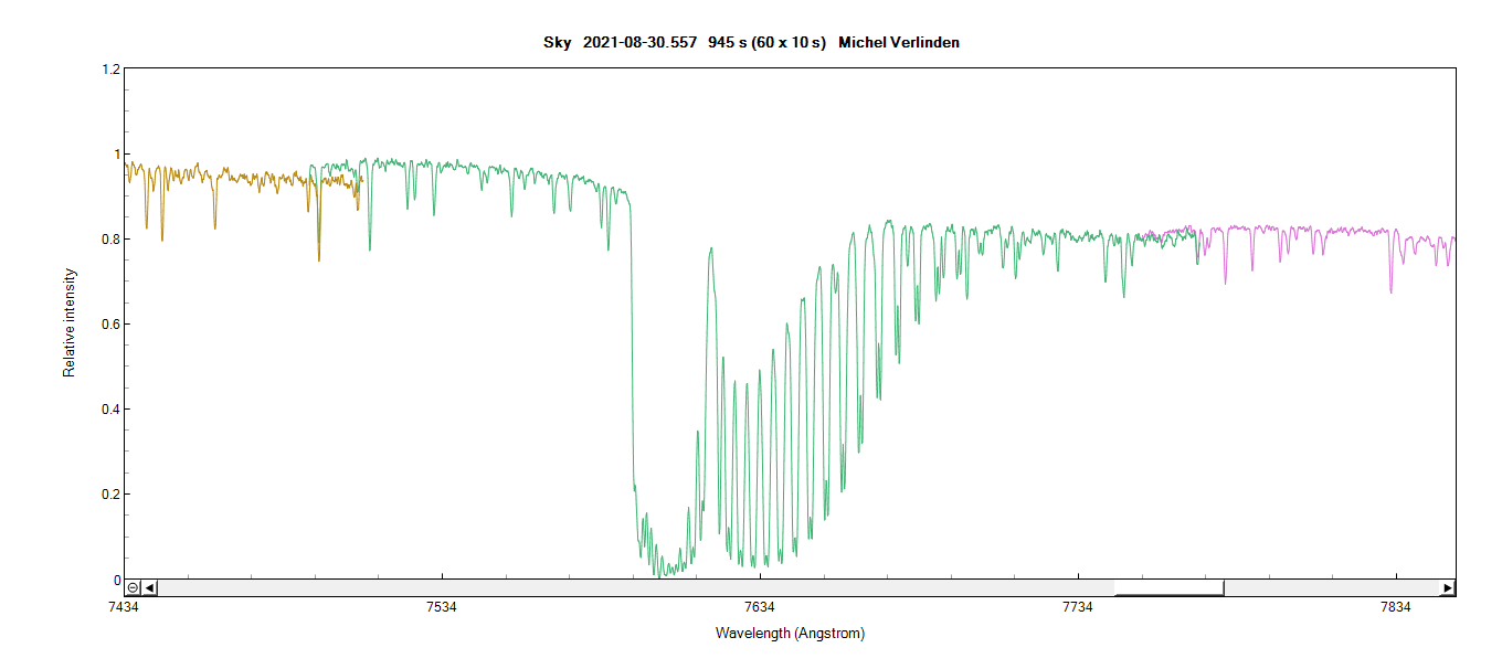

Here are some images and plots obtained on the table, the target is the sky.
Voici quelques images et plots obtenus sur table, la cible est le ciel.
Ordres 25 à 57 non fusionnés: Zoom sur quelques ordres : Ordres fusionnés : Un spectre de test d'Elodie sur le ciel et mon spectre du ciel avec prise en compte de la réponse instrumentale: Tests avec Isis : angle de caméra, détection des ordres et positions des raies d'une lampe Relco SC480: RMS des ordres de calibration : Pouvoir de résolution mesuré dans chaque ordre (la mise au point est dans ce test effectuée sur des ordres excentrés, ce qui explique une moins bonne résolution dans les autres. Une moyenne arithmétique me donne R = 8500. J'ai aussi fait des tests en optimisant la mise au point sur les ordres centraux, je ne montre pas ici). .
Ce spectro echelle est une belle surprise par l'étendue spectrale couverte, résultat de choix matériels et de minutieux et patients efforts. Bravo Joan.
Michel Verlinden
Michel Verlinden

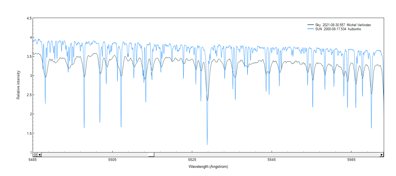

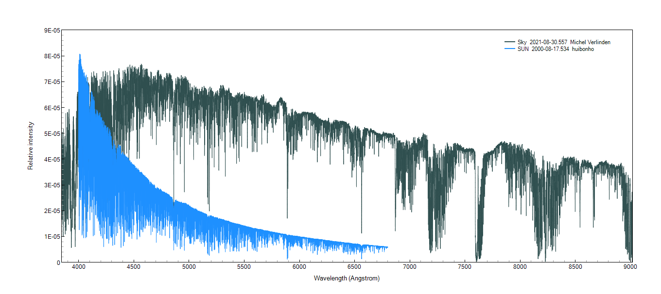

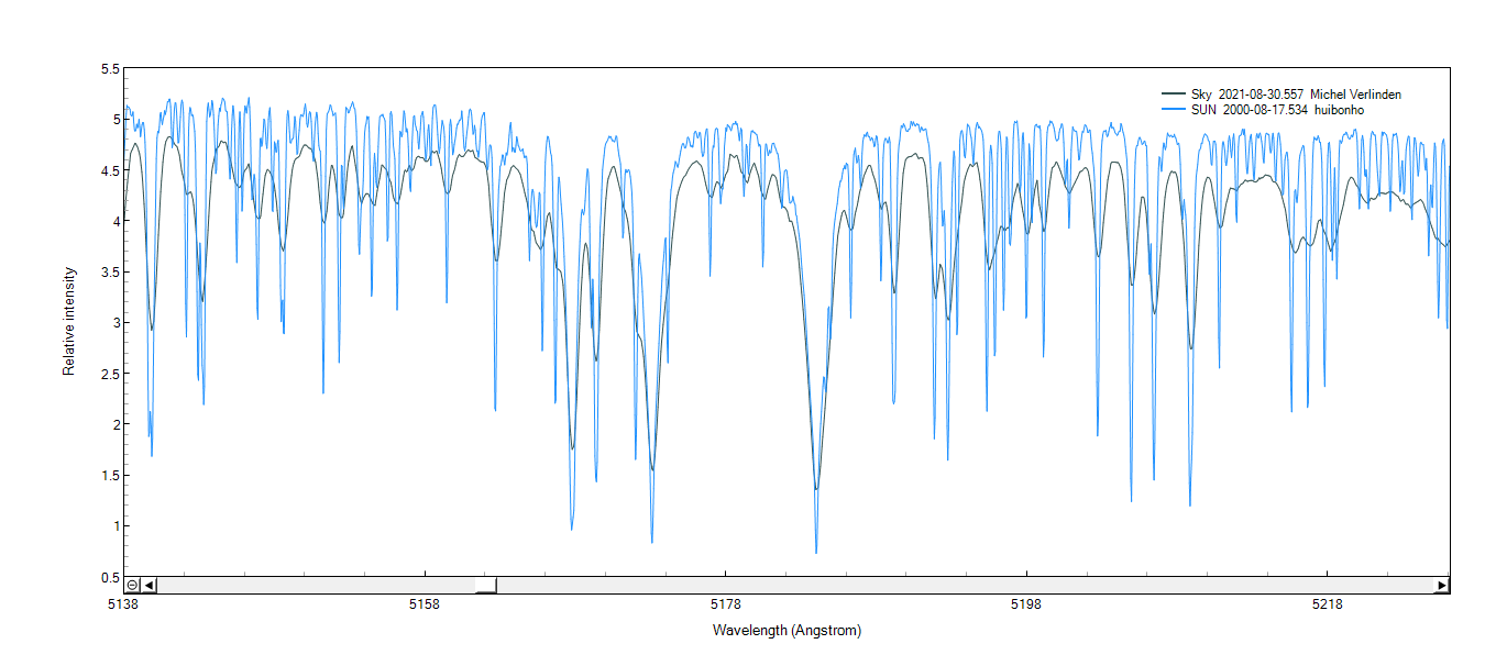

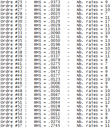

- Posts: 191

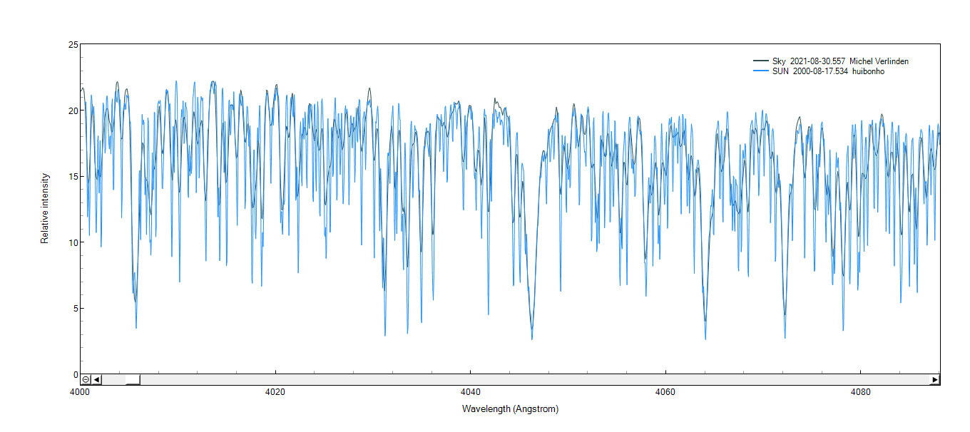

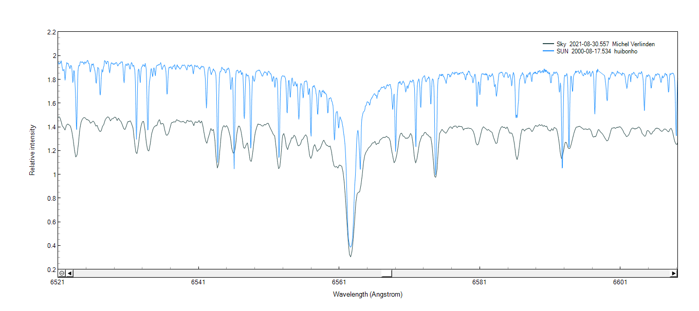

Je complète ici le premier test (effectué avec une Atik460EX), avec une vérification graphique de la calibration en longueur d'onde.
Pris à deux dates différentes, mon spectre du ciel et celui de l'OHP ont été corrigés de la vitesse radiale héliocentrique.
Vers 4000 A : Vers 5100 A : Autour de 5500A Autour de Halpha : Michel Verlinden

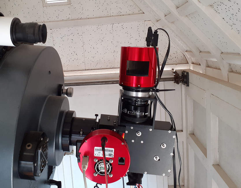

- Posts: 700

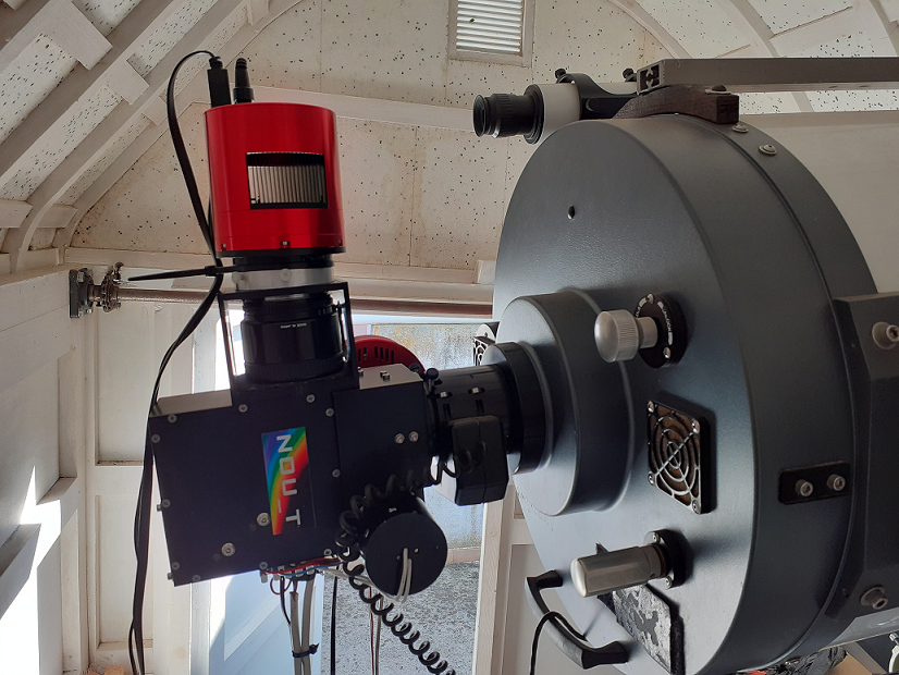

You can see here two pictures of the NOU_T echelle - with a Richardson echelle grating inside - with an ASI2600MM camera. These are on test fase
- I think - with excellent outcomes. You can see them on NOVA Cas 2021 Section Topics.
I have free two NOU_T more nowadays, they are for whoever want them.
Cheers, J. Guarro.
Cheers, J. Guarro.
