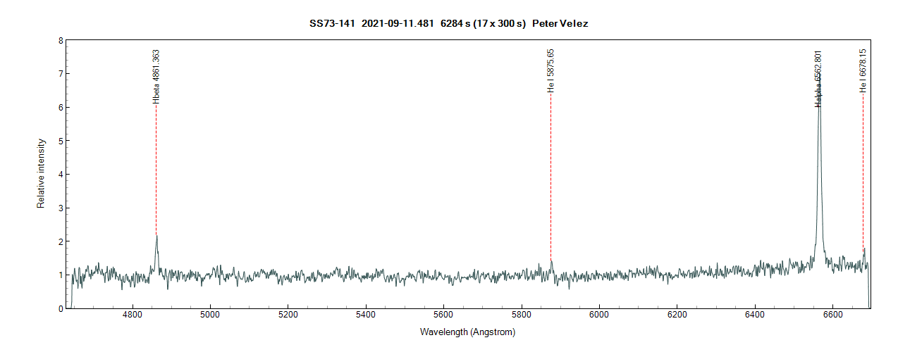

My spectrum from last night - 11 September 2021.
Balmer lines remain redshifted but less so than last week. Its another noisy spectrum - just over an hour's integration time - so its hard to pick up much other than HeI at 5875 and 6678.
Pete
