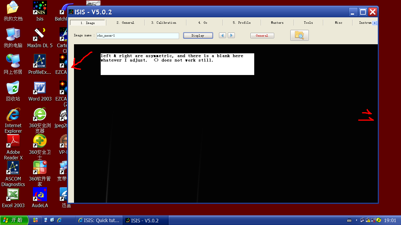

Dear Mr. Buil:
:cry: I am very very sad to tell you that according to those suggestions sent in Yahoogroup, I STILL can never use 5.0.2~~
1). I select smallest characters [my PC has 3 types: small (small is the standard and normal one);big;very big].
2). in "Appearance"---"effect": I uncheck "use big symble".
3). In "Screen resolution” function from desktop, my PC has: 800x600; 1024x768; 1280x600; 1280x720; 1280x768; 1366x768. Usually I just use 1366x768, this time I select 800x600, and plus (1)+(2) setup above, but ISIS can never work and no change. I can never see the contrast slider.
Another strange thing is that I have flat images in working directory as f-1.fit; f-2.fit... f-15.fit, open f-1, click >, image name displays f-11!
In old version 4.3.0, everything works very well. i.e. I name: rho_cas3'-1.fit, here 3'= 3 minutes. Even so 4.3.0 can recognize all images.
I'd like to ask you: if you have old 4.3.0 or others backup? If at last 5.0.2 i can not use, I have to use old one. Could you send me an old version? And I'd like to suggest that you put old versions link for us to download when we want to go back...

Hi Dong Li,
lessson 1: always a keep a copy of the old version before you try a new one. Since you seem to have a lot of trouble with your Chinese computer I try to help once and attach a copy of the previous version:
ISIS.4.4.0.Install.zip
latest ISIS version before V5
(1.28 MiB) Downloaded 575 times
You can also try to reinstall the new version in a different directory.
See if it works.
Regards, Martin
Re: ISIS version 5 (major release)
Hi Dong Li,
Good new for you. I have probably fixed the problem.
Download version 5.0.3, now available (refresh Isis page
if necessary), test and give the resultat.

Hello, Mr. Dubs and Mr. Buil:
Thank you very much for old version, and now 5.0.3 can work.
