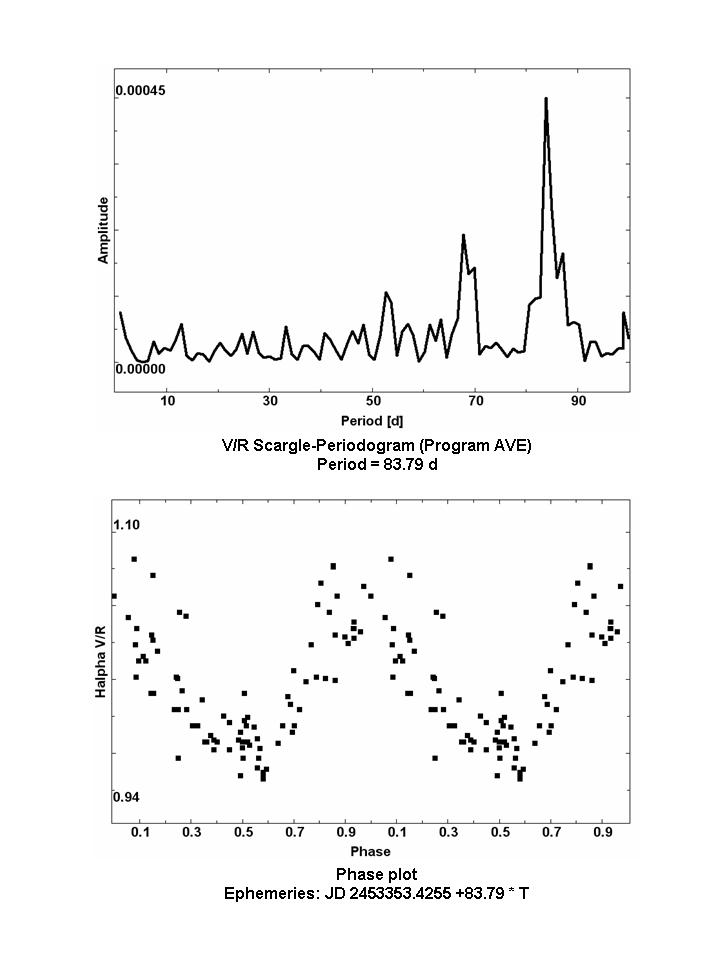

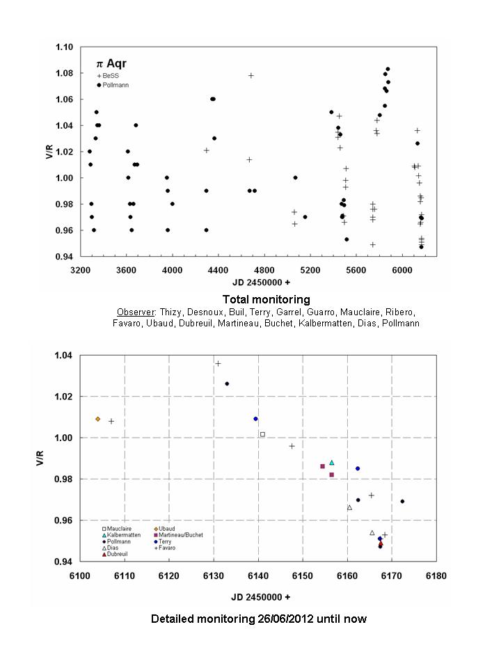

Because the last V/R minimum more or less accurate could be observed, here a preliminary period analysis, on base of all V/R data until now (see attachment).
The period 83.79 d confirms the suggested period of 83.8 d in my IBVS paper No. 6023 (May 2012). Despite this nice result, we should observe further the star for the rest of its visibility phase. Until now a great success of collaboration.

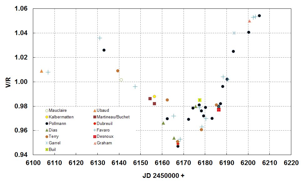

Information for pi Aqr observers:
attached you can find the current Halpha V/R state.
Its maximum has been reached (I guess), and the descent will start during the next few days.
We can be proud, this is the first time, that a full V/R cycle has been observed. If we continue our observations, we have the chance to detect also the next minimum.
So, at the end of the visibility a more precise period analysis will be possible.

A provisional period analysis of the Halpha V/R behavior is to find at:
http://astrospectroscopy.de/VR_piaqr.pdf
I think that the diagrams are self-descibing.
Particularly the campaign analysis, beginning at JD 2456104, has been possible only with spectra of following colleagues:
Urban, Kalbermatten, Debreuil, Favaro, Garrel, Buil, Mauclaire, Martineau, Bouchet, Dias, Terry, Graham, Desnoux.
Thanks to all !!
