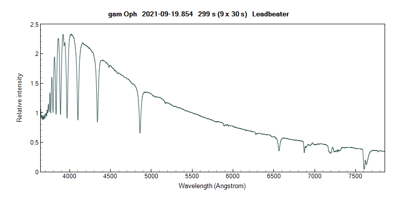

I always use a flat with slit spectrographs and I have never had ISIS fail to produce a useable spectrum with a flat applied.
Here is an example using the ALPY with a flat on a bright star at very high SNR where any deterioration in SNR due to the flat would be obvious. The noise is still not excessive even at 3650A
