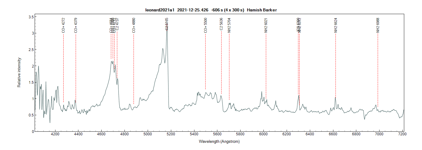

Took this one last night. 4x300s with 175mm f7 newtonian and L200 with 180lpmm grating.
I think my wavelength calibration might be slightly off, if the guessed-at lines are correct.

Is it bright enough for a spectrum of the tail? That can show a very different spectrum. Measuring the spectrum at different points across the coma can also be interesting. Here is an analysis I did of 2020 F3 (NEOWISE) for example.

that one was right across the nucleus, so I also tried selecting the binning region above and below the nucleus so see the difference with less dust reflection. That was just 4x300s, so with more exposure, I think further along the tail should be possible with longer exposures. Also I have just discovered that I had been using the more noisy high speed readout mode on my camera (a very old QHY2Pro). The slow readout seems much less noisy. Yet I did proper measurements of readout noise and gain in high speed read mode and came up with 0.198e-/ADU, 3.8e- read noise, and 0.003e-/pix/sec at -5 degrees. I checked it twice as this seemed a little better than spec (expected 5-6e- read and 0.01e-/pix/sec), but maybe I got a good example. So with slow readout maybe it will be even better, which is great, since it means low motivation to upgrade.
The challenge to distant tail spectrum on the comet may be getting enough exposure time on it before it's too near the horizon. Also, it's raining today, and we are going away on holiday until the 9th from tomorrow, so by then I guess it may be diving towards the sun. At the moment it's reasonably high at end of twilight, about 28 degrees. I haven't looked ahead to see if it will start diving back towards the sun.

How did you remove the dust component? Did you just divide by a solar spectrum?

Re: Comète C/2021 A1 Leonard
Hi HamishHamish Barker wrote:Hi Robin,
Hamish
Dividing but the solar spectrum is sometimes used but it does not work correctly as it affects the strength of the emission lines. You have to subtract the solar spectrum, adjusted for the broad continuum shape of the scattered light. I first calibrated the spectrum for instrument and atmosphere as normal using a reference star. I then subtracted the dust using a G2v template modified to fit the underlying comet continuum shape.

Division by the solar spectrum does not give the correct intensity of the emission lines (for example where the solar continuum is weak, this will exaggerate the intensity of the emission.) To obtain the correct emission line spectrum, the solar spectrum (corrected for the broad shape of the scattering) must be subtracted

To produce the template:Robin Leadbeater wrote: I then subtracted the dust using a G2v template modified to fit the underlying comet continuum shape.
I first divided the background subtracted and response corrected comet spectrum by the Pickles G2v spectrum, filtered to match the resolution of the comet spectrum
I then produced a smoothed curve passing through the continuum points between the emission lines/bands. (The wavelength dependent scattering coefficient of the dust)
I then multiplied the Pickles spectrum by this smooth curve to produce the template of scattered sunlight.
This template was scaled to match the comet spectrum continuum and then subtracted to leave just the emission component.
To produce the cross sections of emission intensity I had to use a different technique to remove the dust component. Here I started with the dark, flat and background corrected spectrum image and took profiles across the comet at the emission lines/bands and at the dust continuum at wavelengths either side close to the emission. The matching average dust continuum profile was then subtracted from each emission profile.
