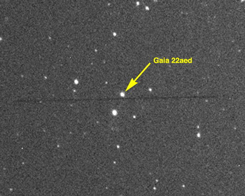

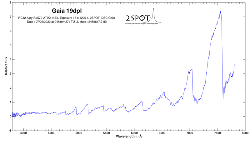

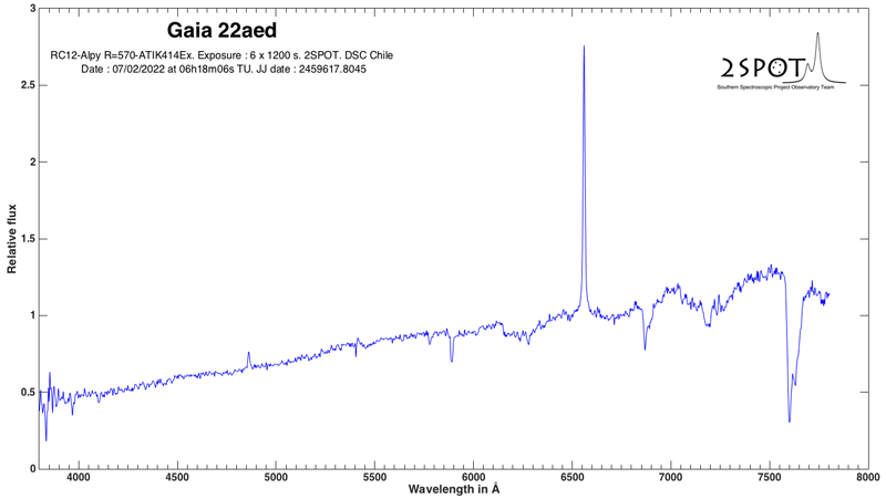

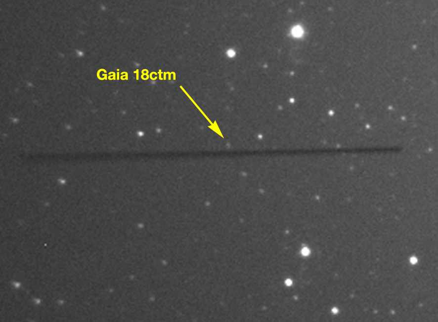

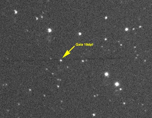

Two spectra of candidates symbiotic stars taken from our 2spot setup in Chili :
Gaia 19dpl
Gaia 22aed
More spectra to come.

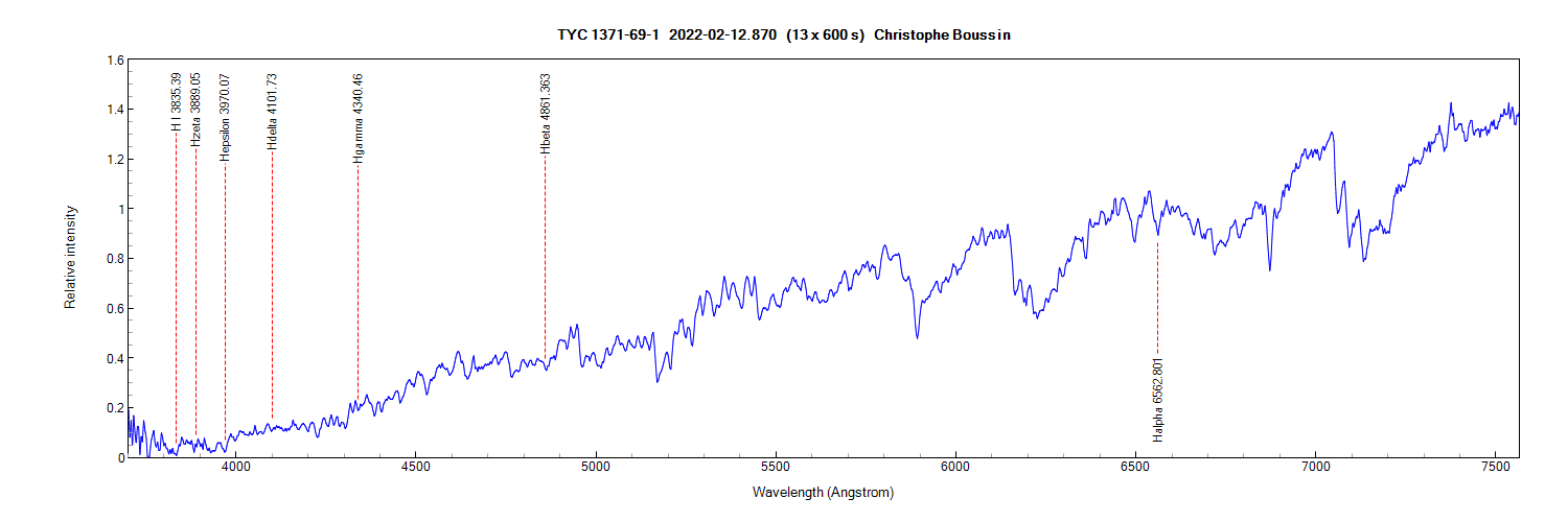

Here is my new contribution to the suspected/misclassified symbiotic stars.
I obtained the following spectrum of TYC 1371-69-1 with a spectral range from 3700 to 7565 A the 12th of February at 20 h 52 TU with my Alpy 600 (resolution of 521, JJ = 2459623.3697) and an acquisition time of 130 min (13 x 600 s) :
TYC 1371-69-1 on February 12th, 2022 (3700-7565 A)
_tyc1371-69-1_20220212_870_Christophe Boussin_3700_7565.png (105.2 KiB) Viewed 19386 times
Identification of Balmer lines from PlotSpectra :
TYC 1371-69-1 on February 12th, 2022 (identification of Balmer lines from PlotSpectra)
No balmer lines are visible in emission.

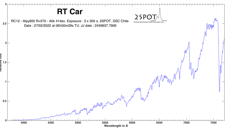

Post by 2SPOT »

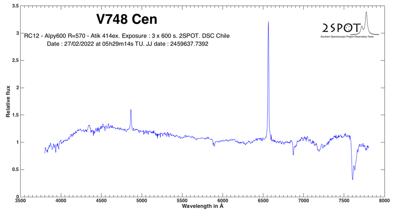

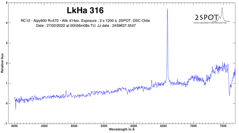

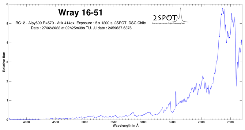

Some Symbiotics candidates taken from Chile
