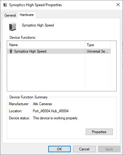

I recently bought from a shop in UK a (quite cheap) Titan aimed at being used on the ALPY. I have already an Atik414ex which works without any problem in W10. But I fail using the Titan, even connecting it through PhD2 or Prism or even Artemis Capture.
I have the latest core software fully installed as well as ASCOM 6.4-SP1. The link between the Titan and the atik driver is not done automatically, that's fine I select the driver repo manually: Atik Cameras/Drivers/64Bit and it finds it.
This is my first question: the selected driver for the Titan is named 'Synoptics High speed' (see picture attached). Is this expected? According to W10 the driver works fine. But the camera remains undetected by Prism, PHD, etc...

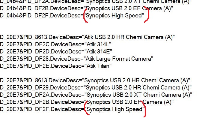

I had today the answer from Atik support (very reactive btw): it seems that my camera is not a Titan but a ~15 y-o Synoptics Art 5.5mp (according to Atik, I could not find anything about such a camera on the web). For what I understand, Synoptics had a kind of OEM partnership with Atik long time ago, which can lead to the confusion (same case,..). The trick is : check if there is the Atik badge on the case.
This badge is not present on mine. So that’s basically the end of the story, 180£ to the trash.

Looking for a Synoptics driver online I came across this web page https://www.driverscape.com/download/sy ... ra-%28a%29 I downloaded and unzipped with no issues and looking through the setup information page I noted that the "Synoptics High Speed" driver is included with the Atik cameras,could be worth trying if you haven't done so already.

Yep I tried that already but without success. Thanks for looking at this :)
