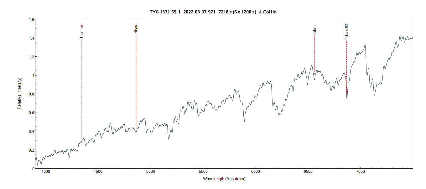

Here is a spectrum of TYC 1371-69-1 from last night using an Alpy 600, Celestron 8 SCT, 1200s x 6. I can't see any Balmer lines in emission.

This compares the spectrum with the Pickles reference spectrum for M 1 III. It looks a reasonable match.

@ John. Excellent, good practice to provide the field!
