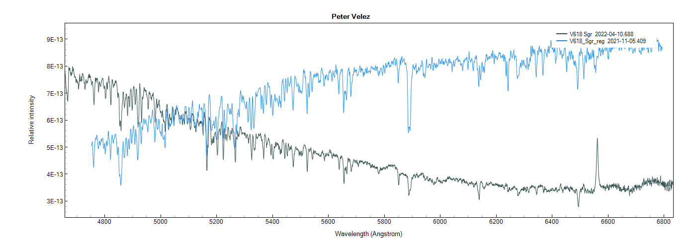

- Posts: 153
I had a look back at my last spectrum of V618 Sgr which was taken in November 2021. Here is a plot of both.
There is quite a change in continuum. Both spectra are flux calibrated so they are reasonably comparable.
The other big change is in the Ha emission.
Pete
Pete
- Posts: 1268
Hello Pete,
Nice evolution in only 5 months....
A target to follow....
- Posts: 1955
Wow! that is a big apparent change in temperature for no change in V mag. (similar flux at 5200A) How does that happen?Peter Velez wrote:
- Posts: 153
Not sure Robin - hopefully not poor processing on my part!
Will have another look at it soon
Pete
Pete
