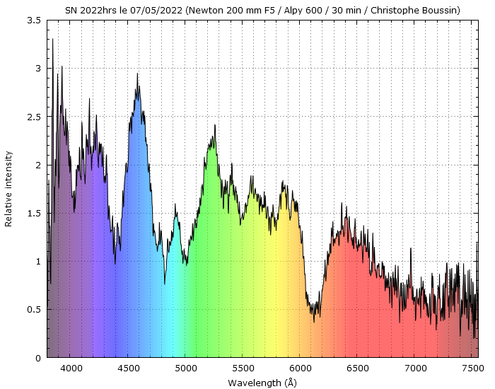

This is my first attempt to get a supernova spectrum !
The spectrum is unfortunately noisy but it seems to me that it shows some changes compared to the first spectra in this post...?
Many thanks to Joan Guarro Flo for sharing the files of his incredible echelle spectrum of SN 2022hrs !!
He convinced me of the reality of the overall shape of my spectrum !
Here is my spectrum of SN 2022hrs obtained with my Alpy 600 the 7th of May at 22 h 06 TU (resolution of 526, JJ = 2459707.4206) and an acquisition time of 30 min s (3 x 600 s) :
SN 2022hrs on May 7th, 2022
_sn2022hrs_20220507_921_Christophe Boussin_3800_7560.png (86.49 KiB) Viewed 5224 times
It's mind blowing to think this is the spectrum of a "single star" in another galaxy...clear skies to all !!

Congratulations on your first supernovae Christophe! Here are my spectra so far in the BAA database
https://britastro.org/specdb/data_graph ... end_pos=ne
You can download them from the database and compare them with yours if you like
Notice how the absorption features are moving to the red as we the slower ejected material deeper in the explosion

Yes Robin you thru !
V ejec = ((6107-6355)/6355) xc) -1409
V ejec = 13 108 km/s [+/- some mistake] lol :D

Thanks Robin !
I downloaded your spectra and compared the one of May 4 with Joan Guarro Flo's (May 5) and mine (May 7): they are in good agreement....except the resolution of course ;) !
Very interesting to see the evolution of the velocity from your spectra : thanks for sharing !
Let's hope we can continue the monitoring of this supernova !
