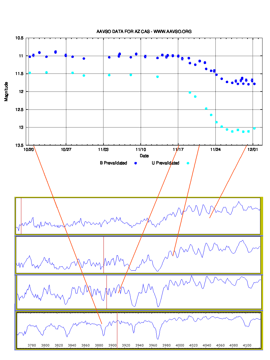

The spectrum in the region 3760-4120A show some large and rapid changes during ingress. Unfortunately these are almost impossible for me to record now the brightness has dropped (The last spectrum is 10 hours exposure over 2 nights :o ) Cezary also has problems recording in this region (See note from him below) so although not very good, my spectra may be unique. Is anyone else able to record in the region, for example using a LISA and a camera with better blue sensitivity?

Posts: 1432
Re: AZ Cas 3760-4120A changes during ingress
Robin you are a brave man!
The object is so faint in the blue region....
The result is spectacular.
Personnaly, I concentrate my effort on Halpha line (perhaps an error?).
Clearly LISA can capture the AZ Cas blue features with high efficiency. But, for me, the weather is not
very favorable for change quicky the spectrograph at the focus of the telescope during the same night.
I encourage all LISA users to monitor AZ Cas !
