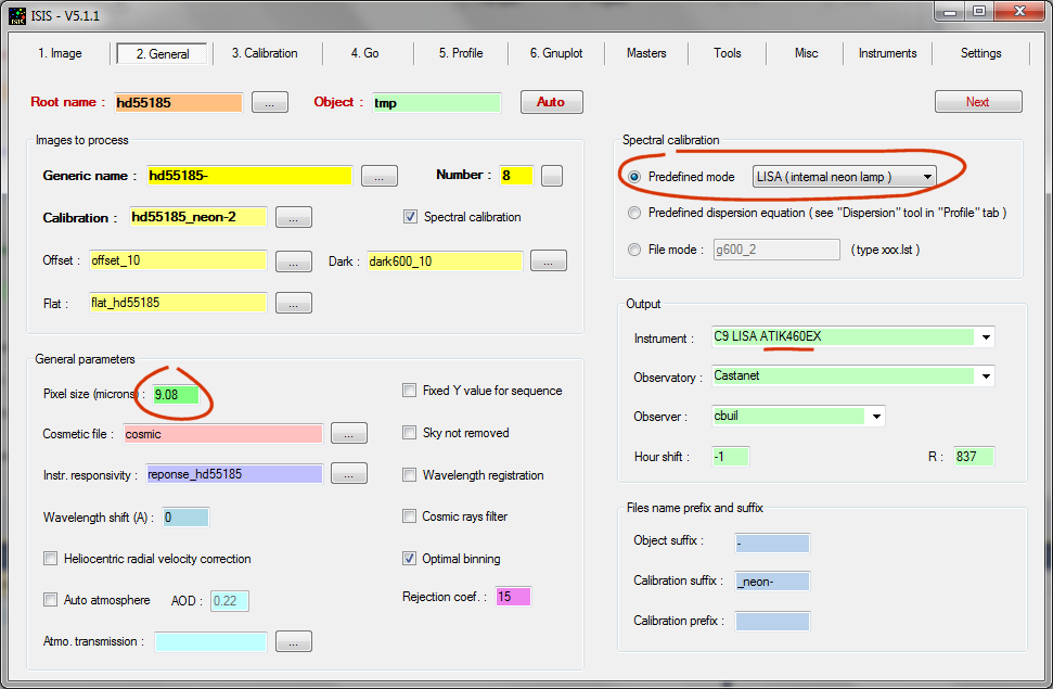

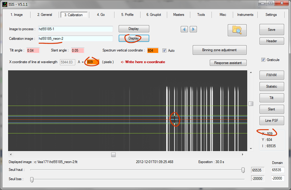

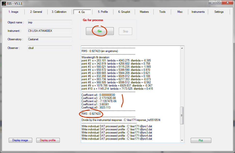

Pete,
First, the base pixel size of ST-10 ME is 6.8 microns, and for binning 2 x 6.8 = 13.6, not 13.8 microns. Correct if necessry.
Second, if you select the good calibation option (LISA internal neon) the spectral calibration assistant button disapear in "Calibration" tab
(this assistant is now not necessary). Look screen copy for a typical run (note, I use an Astik460EX camera with 9.08 pixels size) - in the order
calib1, calib2 and calib3.
A final point: my neon calibration image is well exposed for the purpose. Here a 30 seconds exposure for extract the faint blue/UV line of
gaz trace in the neon lamp.
Check the differences and give the resultat.

As you might expect - there was a combination of errors. For those wanting to learn from my mistakes, here they are:
1. My arithmetic is lousy. 6.8 x 2 = 13.6 not 13.8. I had entered the incorrect pixel size - as you rightly spotted
2. I had been using a neon image taken from the day prior to the target images. I think there was a different tilt in the neon image to that of the target image.
3. I was trying to refine the neon only calibration with the Sun rather than an A star so the calibration was never suitably improved.
Putting all this together, I calibrated an image of Fomalhaut with neon only. This yielded a RMS of about 0.2 pixels which translated to a RMS of about 23 A. Not a great result. This was without applying bias, dark or flats. I then used the Calibration Assistant with the Ha line from the Fomalhaut image - which was easy to spot in such a clean profile. The RMS dropped dramatically - to around 0.2 A from memory. I used the Response Assistant to produce a response curve, added bias, dark and flat frames and combined 5 images rather than the single image I used initially to calibrate and produced a better profile.
To test this, I then produced a profile for a nearby A2V star - around mag 5 and produced a very clean profile for that too.
All going well, I'll attempt a few fainter targets with longer integration times and see how it all runs.

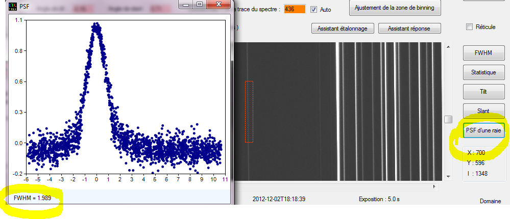

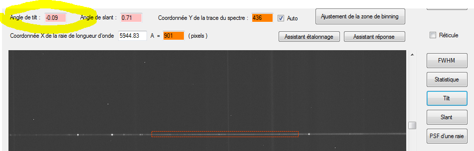

The best way to tune the autoguiding cdd is to proceed indoor, on a table, with daylight, like explained in the Lisa Documentation provided by Shelyak
For memory :
http://thizy.free.fr/shelyak/Lisa/DC001 ... -%20En.pdf , pages 12/13
The acquisition CCD can alos be tuned on the table :
1. Focalisation on neon lines. You can use a very efficient function of ISIS : the FWHM of a neon 2. Rotation of the CCD in order to get an horizontal spectrum
I use for that the pinhole 19 mcm of the additional slit for LHRES/LISA. You can use tape behind the slit
On this recent image (CI Cyg), I have a 0.09 angle from horizontal. Almost good ...
For memory :
