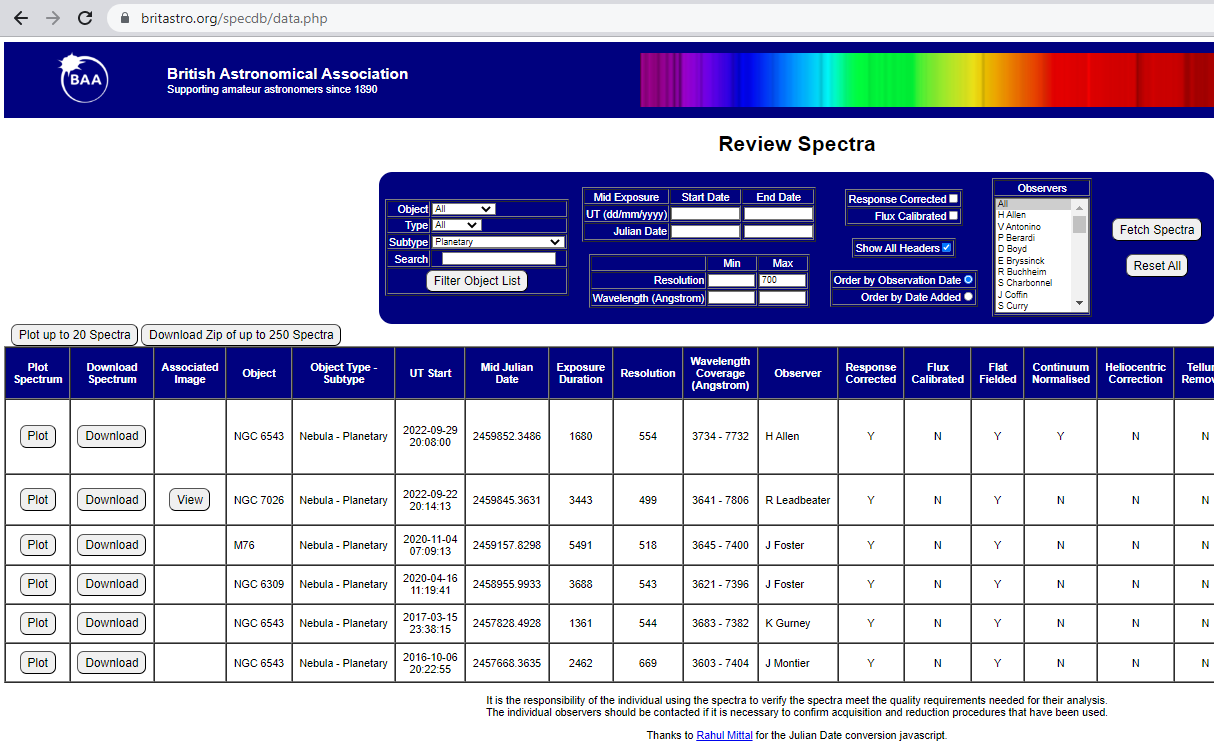

- Posts: 1955
Re: Spectra data of PN acquired with Alpy as reference
There are also some spectra of other PNe taken using the ALPY 600 in the BAA spectroscopy database
And Francois Teyssier's analysis of NGC6293 here might also be of interest
http://www.astronomie-amateur.fr/feuill ... C2392.html
