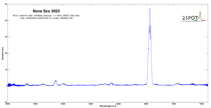

Post by 2SPOT »
Another spectrum taken this morning.
The evolution of the nova day after day, is smaller and the magnitude continues to decrease to mag. V=9,75, but we still manage to make its spectrum with the eShel spectrograph.

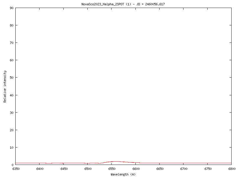

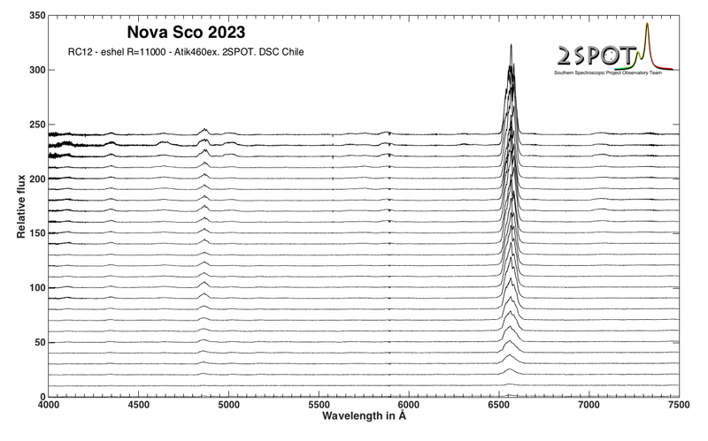

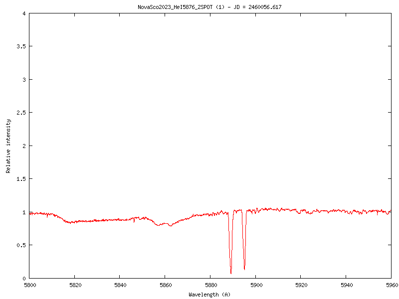

we have been following this nova day after day for 2 months now.
Here is a graph showing the global evolution of the spectrum with all our spectra acquired so far.
And some animations on the lines:
H alpha

HeI 5876
