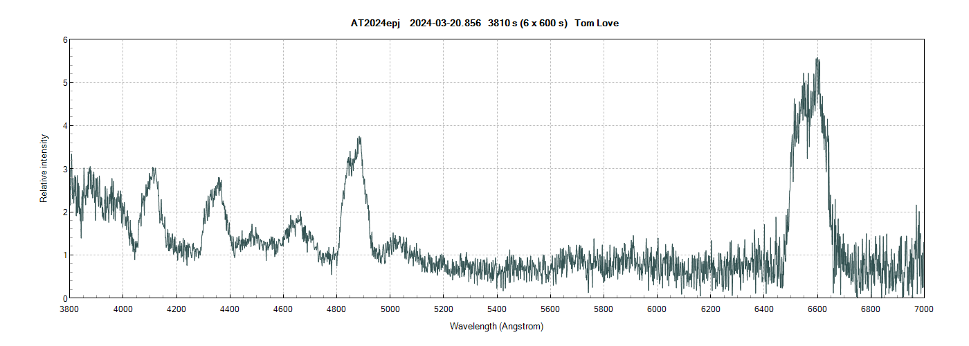

And this is what I've managed with an Alpy. I suspect it's a little fainter than the 10th magnitude it has been estimated at. Similar result of about +/- 4200 km/s for the expanding shell.

Tom Love wrote: Wed Mar 20, 2024 12:36 pm And this is what I've managed with an Alpy. I suspect it's a little fainter than the 10th magnitude it has been estimated at. Similar result of about +/- 4200 km/s for the expanding shell.
Yes the latest report on TNS suggests it is fading rapidly
2024-03-18 18:34:24.000 11.56 (sloan g)
Posts: 1565
Re: AT2024epj - A mag 10 transient in/near the LMC
Good result despite the low luminosity
Very fast nova.
Expansion velocity 4900-5100 km/s measured on H alpha and H beta.

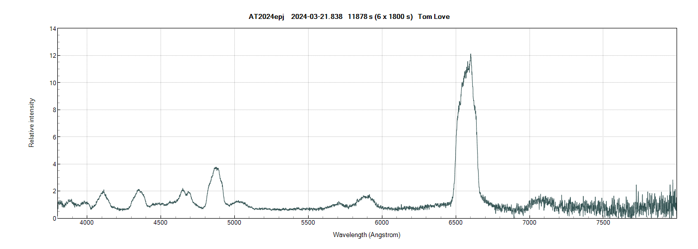

And an updated observation. This is a long (3 hour) exposure which shows a little more detail, though it's a bit noisy as we approach the near infrared. FITS files uploaded to the ARAS database as usual.
H Alpha in velocity:
at2024epj_ 20240321_838_Tom Love_HAlpha.png (21 KiB) Viewed 10477 times

Nice result Tom !!!
And this is the confirmation of our previous spectrum.
We wil try again next night with our Alpy 600 at 2SPOT in Chile....
