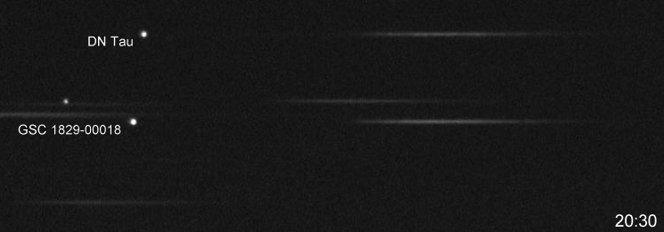

On 2012-12-09 I detected a remarkable transient in the spectrum of DNTau using the Star Analyser.
88 x 20 sec spectra show a rise in total flux (4000-7500A) of ~130% in just 6 minutes, followed by a rapid drop over the following 6 minutes and a continuing slow fall over the next 40 minutes to ~20% of the initial level. The flux increase was greatest at the blue end (a 300% increase at 4500A)

A remarkable large, fast transient in the spectrum of DN Tau
- DN_Tau_20121209_imaqe_anim.gif (282.67 KiB) Viewed 42405 times

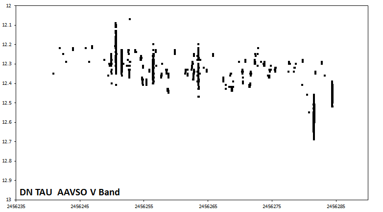

Such behaviour looks common for this star.
Here's the AAVSO light curve in V Band Varitations at hour time scale are frequent
Time serie at higher resolution with LISA or LHIRES 150 l/mm should be interesting

Yes such variations should be easy to see in the photmetry. (or even visually - there are anecdotal reports of flickering seen in this star apparently) The V mag perhaps increased by ~ 1 magnitude during this event and the B mag by even more! I have posted on the AAVSO campaigns forum encouraging photometrists to measure their individual exposures for this project and not to average them as is often done.
