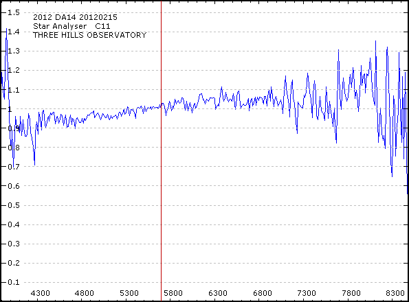

Hello Christian,
Interesting. I am still reducing my spectra (I have about 50) but your spectrum slopes the opposite way to mine. (See attached, taken with a Star Analyser and a 0.28mm aperture,divided by G2v star HD107582) My result is consistent with it being a spectral type L asteroid as published.
http://echo.jpl.nasa.gov/asteroids/2012 ... nning.html

Re: Asteroid 2012 DA14 (T940 tel. and new spectro.)
Hello Christian,
I see the same effect even when the asteroid and reference star are both > 50deg elevation so there should not be a big atmospheric effect. Perhaps our reference stars do not not have exactly the same spectrum. I will complete all my processing and then we can make a full comparison. I also have an A star reference which I used for wavelength calibration so I can measure the instrument response and produce flux calibrated spectra to compare directly with yours.
