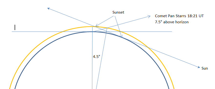

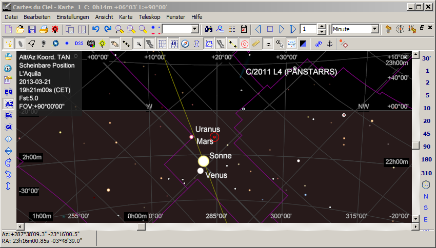

very nice spectra, Paolo! About the Na emission over the whole length of the slit I am inclined to the opinion of Fil, that it may be caused by the Na flash in the upper atmosphere. A thin Na layer is located at about 90 km altitude and the yellow resonance fluorescence excited by sunlight. It is only observed a short time during dusk, when the sky brightness is low enough and the sun still illuminates the layer. Those at OHP may have seen the impressive demonstration of Peter Schlatter when the twilight Na absorption suddenly switched into emission and later into absorption again.
Based on the date and time of the spectrum I did arough calculation of the geometric situation.
sky view for L'Aquila at time of spectrum
At time of the spectrum (21st March, 18:21 UT) the sun was about 11.5° below the horizon at L'Aquila, the comet about 7.5° above the horizon according to CdC.
At an assumed altitude of 90 km the horizon is at an elevation of -9.5° or about 1000 km to the west. Since the sun is already 11.5 ° below the horizon, the sun would not illuminate the Na layer in the zenith. Howwever the spectrometer looks at an elevation of 7.5° to the west. The view ray intersects the Na layer about 4.5° to the west, as a little bit of trigonometry shows. At that point the Na layer seems still illuminated by the sun:
geometry of observation
The diagram (not to scale) shows the approximate situation. Apparently the visible range of the Na flash would extend to an elevation of the sun of 14° (9.5 + 4.5) below the horizon. This would be around 18:35 UT. If the sky background spectrum was taken later than that it would be clear that the Na flash has disappeared and cannot be subtracted from the comet spectrum. That would explain the almost constant Na emisssion strength over the length of the slit, where comet tail intensity is low. Crossing the tail one sees the increase in intensity of the Na emission from the comet.
These arguments make it plausible that the background Na emission is indeed of terrestric origin. It is not a proof. A test would be to record a sky spectrum at the same elevation with the sun the same elevation below the horizon or even better a time series and see if the Na emission is there without a comet. Unfortunately the weather has not been very good around here, I did not even see the comet yet.
