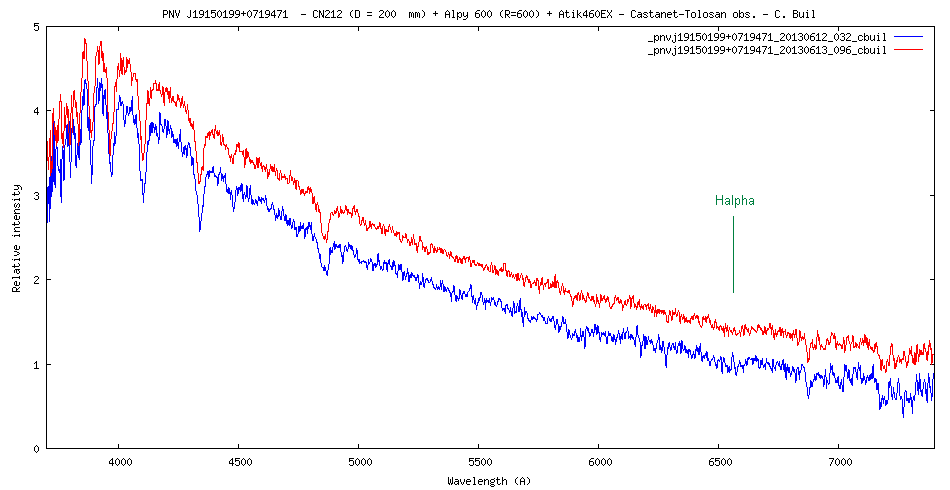

Posts: 1432
Re: PNV J19150199+0719471 in Aql
The aspect of the spectrum evolve. The Halpha
is faintly visible the 12/6 and not visible in emission the 13/6.
(exposure time is relativement short for the two obervation, 4x600 sec.
on a 0.2-m télescope).
