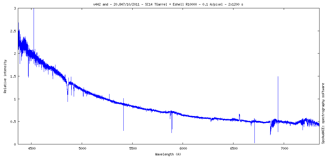

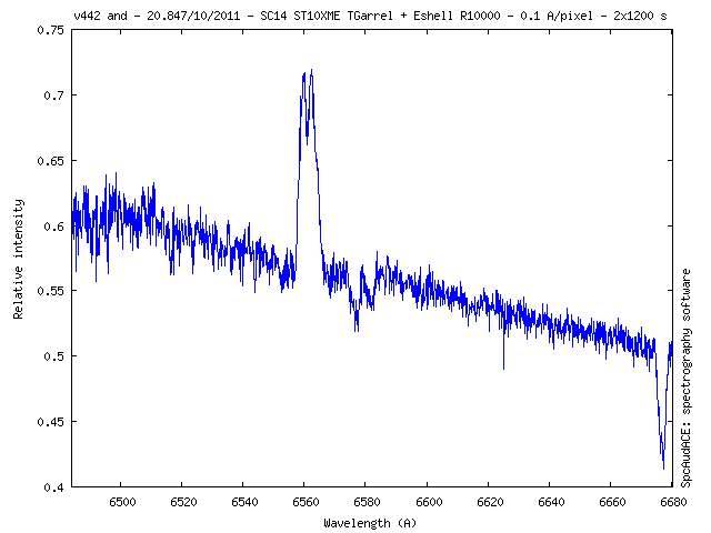

Once again, V442 And seems to enter in an outburst phase. Very intersting star who known in the last two years two outburst !
http://arasbeam.free.fr/spip.php?page=b ... toile=1908 Note that last observation from Valérie Desnoux was from Oct 1st
I was lucky to discover both last ones, Christian Buil and Valérie Desnoux, apart, have seen two ancients outburst of this star in the last two decades.
So observations are highly recommended to constraint a possible period and to describe this new phase.

- v442_and_20111020_Halpha.png (6.74 KiB) Viewed 10063 times
- v442_and_20111020_847.png (7.73 KiB) Viewed 10063 times

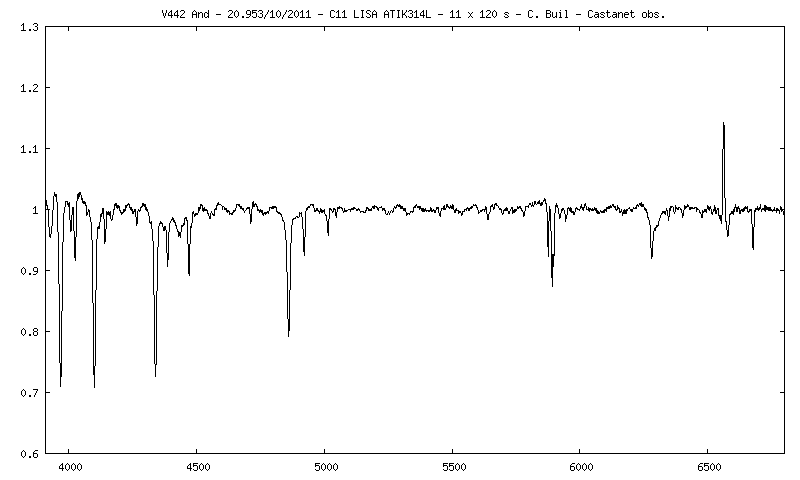

I have observed the same night after your message (LISA + C11 F/10). The outburst is well confirmed.
(the continuum is rectified on the plot).
- _v442and.png (5.21 KiB) Viewed 10053 times

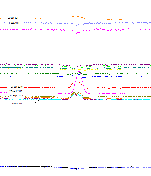

Few more curves to show past evolution of the last outburst.
In one month the emission seemed to have increased suddenly. So it is interesting to monitor the star almost on daily basis if it is a same type of outburst. This a time scaled profiles diagram, with some key dates added. Spectra come from BeSS. Atmospheric lines are removed and the heliocentric speed is corrected through Vspec.

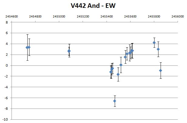

Here is a rapid EW graph Valerie
