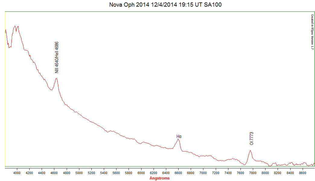

Here's the CBAT page http://www.cbat.eps.harvard.edu/unconf/ ... 43481.html - this nova was discovered a couple of days ago.
I got a low-res SA100 spectrum last night. Strong blue continuum. Odd sort of line profile - weak Ha emission line, no sign of Hb, but a stronger He/N(?) emission line around 4680. Possibly a He/N type nova close to maximum?
nova oph 2014 12-2.jpg (90.82 KiB) Viewed 4683 times

Hello Jon,
He II and NII should appear later, about 3 mag under maximum (only low ionization lines near maximum)
Also OI identification is uncertain
The spectrum could be that of a dwarf nova outburst in a WZ Sge cataclysmic
Watch this space
