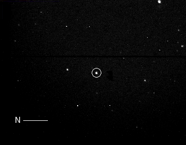

Field of view

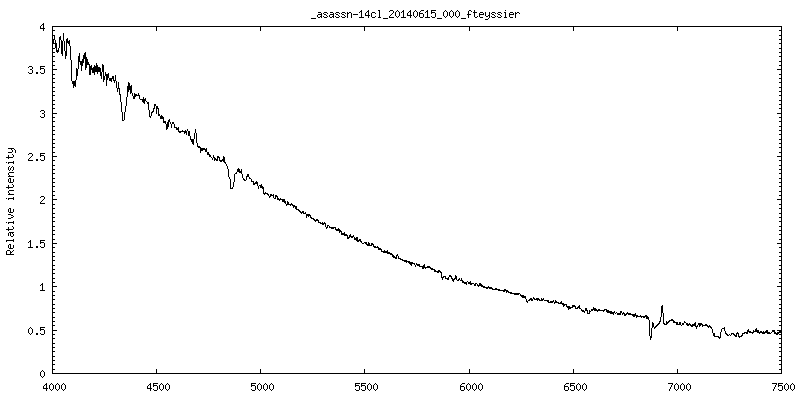

CV in outburst, with noticely He II in emission
Line at 6926 is a cosme, not removed

Excellent reactivity! A rare event at this magnitude

Thank you Christian
Here's the ATel reporting the identification
http://www.astronomerstelegram.org/?read=6235

I was able to get a spectrum through high altitude haze on June 16th (calibrated using HD208906 and the Miles spectrum).
Don't seem to be picking up the He II emission... :?:

The changes in spectra of DN in outburst are very fast.
See for instance SS Cyg : http://www.astronomie-amateur.fr/feuill ... 20Cyg.html
However I'll verify my images.
Could you send me your spectrum for the database, Tim?
