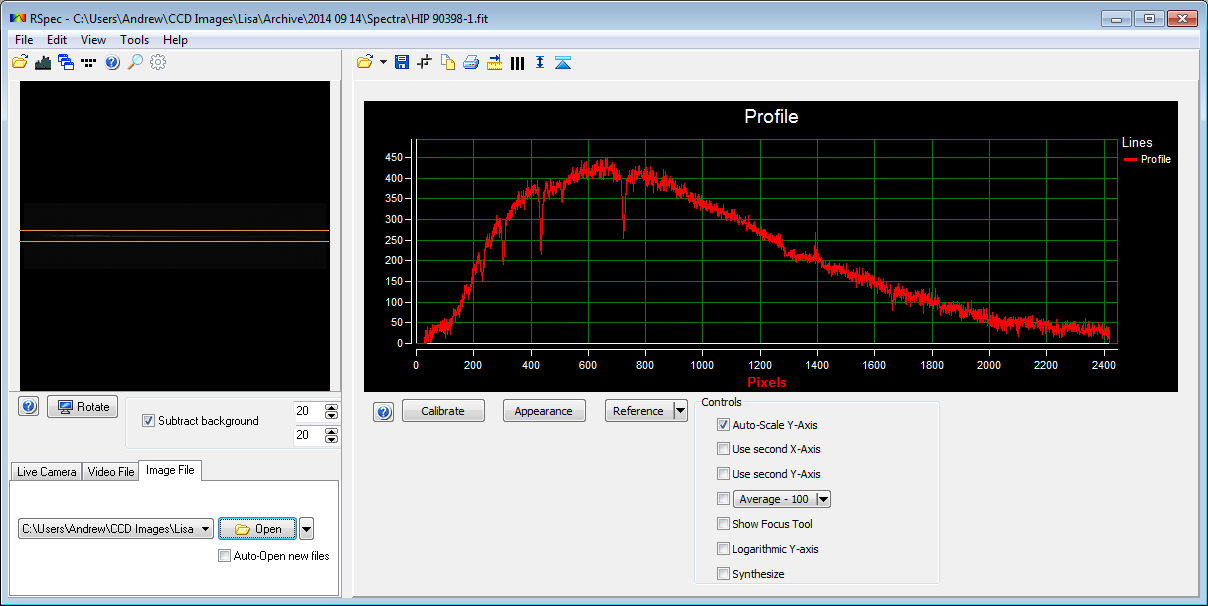

I attach 3 spectra as I would see them come in across the range of magnitude. Remember they are just to see if the star has any emission features and so the S/N is lowish (too low for the faintest object). The aim is to maximize the number of stars surveyed.
Regards Andrew
