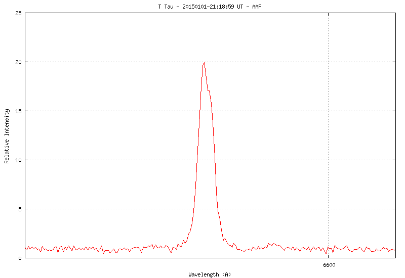

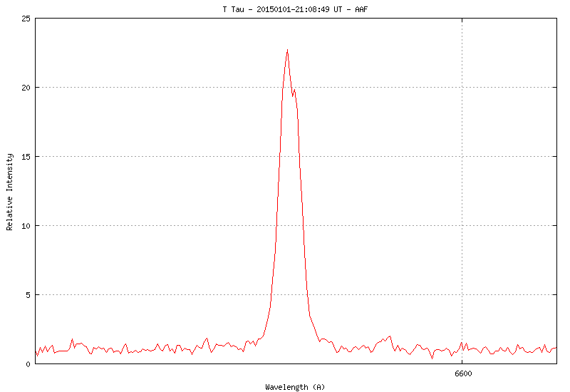

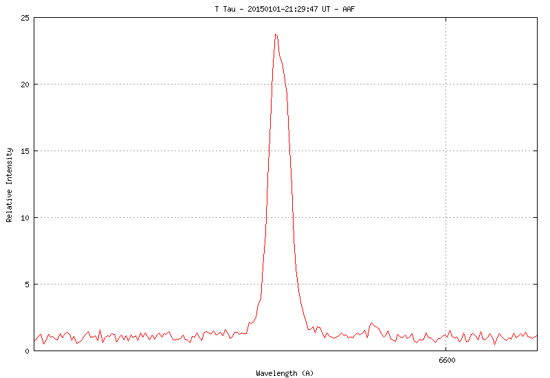

Paolo Berardi wrote: I'd like to point out that some T Tau spectra were taken also by A.A.F. members (Amateur Astronomers Association in Florence) and, at low resolution, by U. Sollecchia (L'Aquila).
Hi to everybody.
As per Paolo message here below our spectra taken few days ago.
Hoping they can be useful.
Bye
Max & Nico

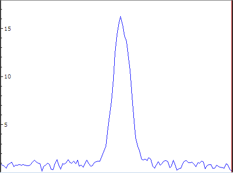

T Tau 3 - 20150101-212947-3.png (5.33 KiB) Viewed 14866 times
T Tau 2 - 20150101-211859-2.png (5.04 KiB) Viewed 14866 times
T Tau 1 - 20150101-210849-1.png (5.27 KiB) Viewed 14866 times

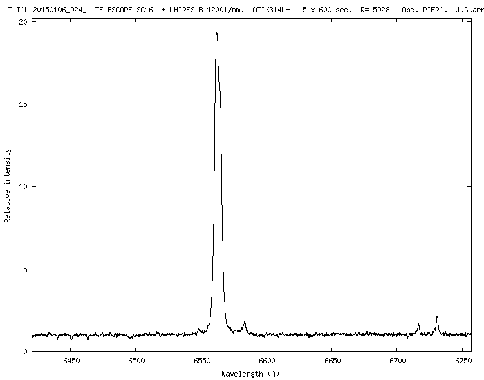

This is the first time I observe the T Tauri, who I should send the FITS?
Thanks J.Guarro
_ttau_20150106_924_J. Guarro.png (5.46 KiB) Viewed 14815 times
