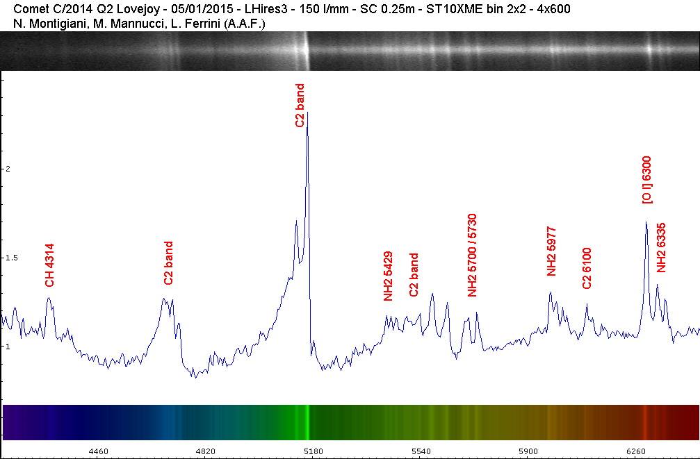

Hello to everybody.
This is our small contribution.
Done with Lhiress III and 150l/mm grid.
Full moon and some clouds didn't help us. :|

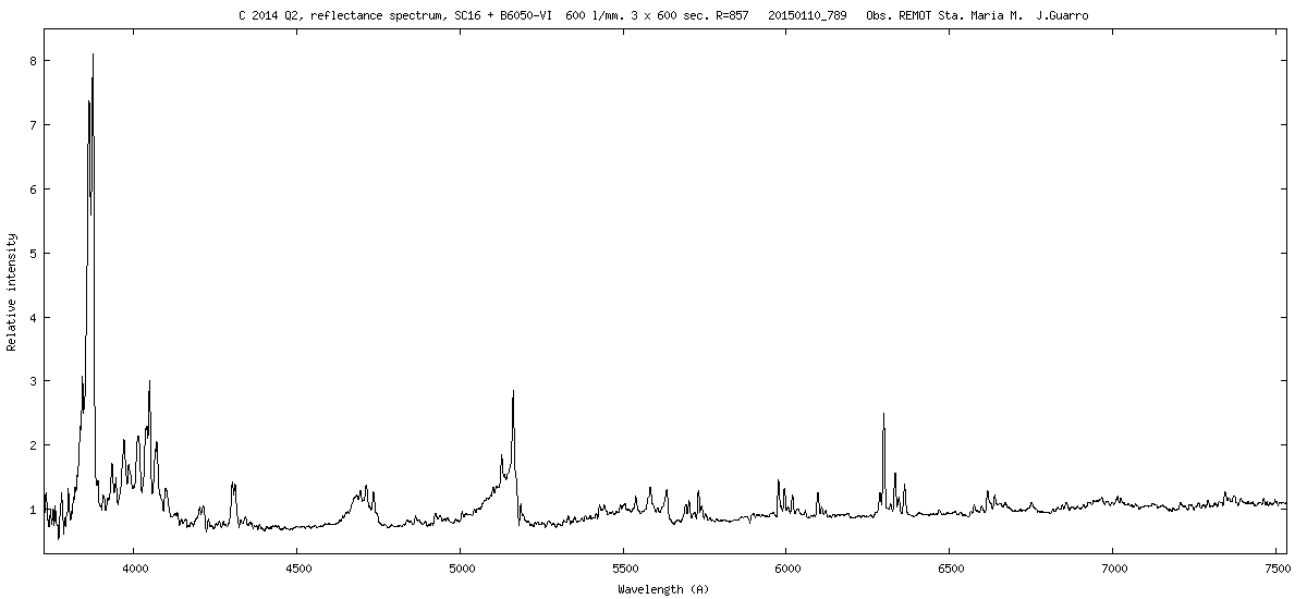

A respite from fog in Sta. Maria let me observed again the C / 2014 Q2.
J.Guarro
