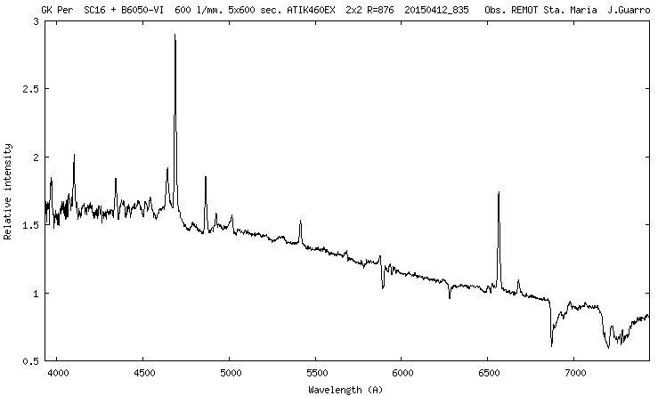

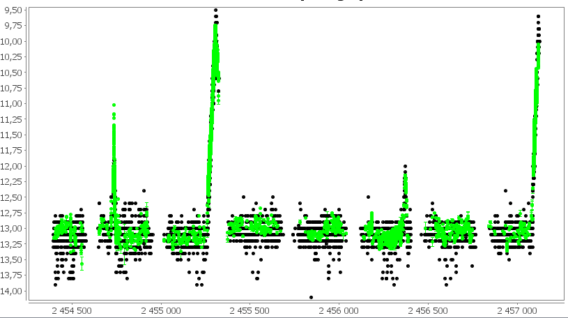

The cataclysmic -polar intermédiaire- GK Per (Old nova Per 1901) is in outburst at mag V = 10
The last strong outburst occured in 2010
Joan Guarro obtained an interesting spectrum last night

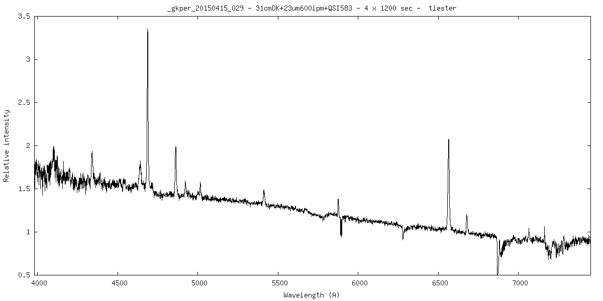

Here is my spectrum for 2015-04-15.
According to light curve on AAVSO it is near maximum, perhaps just starting to decline.
