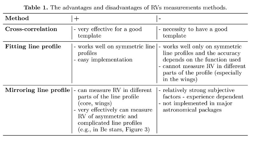

the following table (source: above website) summarize pro con of different methods used to compute the RV:
basically the mirroring method is based on the bisectors method and in the following pubblication it is very well explained how the bisectors method works:

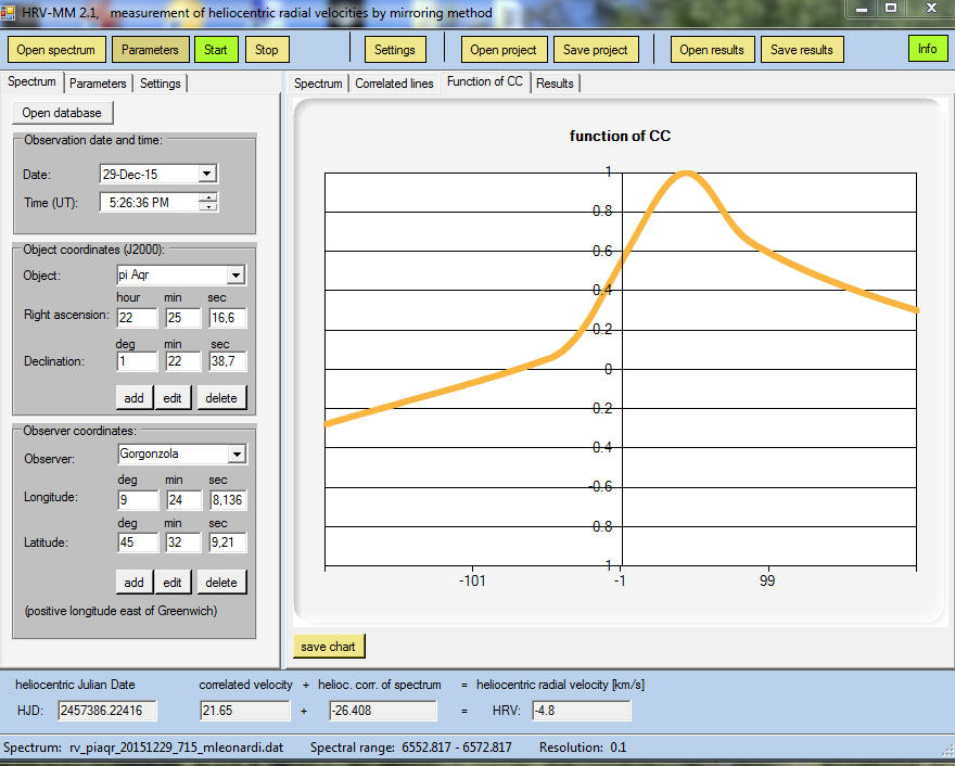

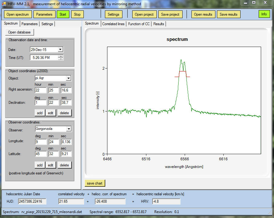

I am testing the software on my last spectrum of pi Aqr, the last one approved by BeSS and dated December 29th , 2015.
I got a Radial Velocity of -4.8 km/sec but I wonder if the value is correct. To be honest I do not how to select correctly the spectrum zone. I have enclosed to this message two images of the different software windows. What do you think ? Is it correct my way to proceed ? What is the "Function of CC" window ?
is it correct to select spectrun zone in this way ?
may be Ernst can clarify some of my doubts. I think it could be useful not only for me but even for others to post my experience and questions. I found the RV matter very interesting.
May be some other of you is using this tool ? What do you think about the mirroring method vs cross-correlation method ?

Dear Marco,

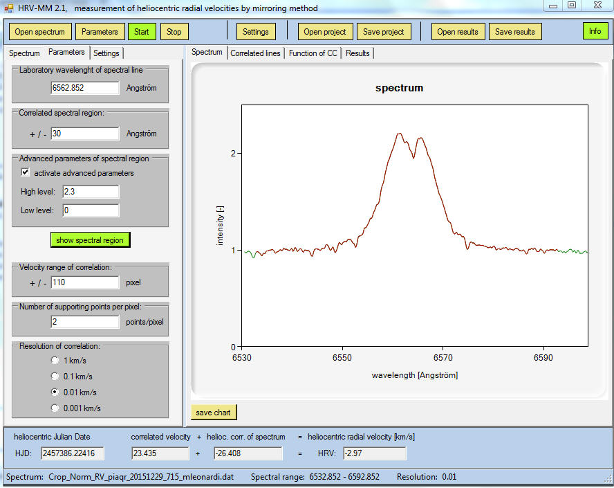

I am very pleased of your attempts to calculate the RV of pi Aqr. In case of your last spectrum, I would prefer not to use selected sections of the profile, but to use the entire profile (see the following picture). In that picture you can recognize the corresponding parameter for the process "advanced parameters of spectral region": high level = 2.3, low level = 0. Corresponding the spectral parameters in your spectrum (dispersion and spectral resolution power) you have to select certain values for "correlated spectral region" (I selected 30 Angstr.) and for "velocity range of correlation" (I selected 110 pixel), laboratory wavelength = 6562.852 A.

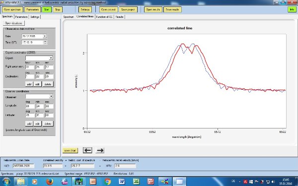

With these pre-settings you can start the measurement "correlated line" (see the following picture) and the function of CC (see the following picture). Sometimes you have to "play" with this settings, depending on the lineprofile, in order to find out the best result of the CC.
The CC determines the size of the shift of the spectrum and/or a comparison (mirrored) spectrum (both leads to the same results, if one considers the direction of the shift), which is necessary, in order to obtain a maximum agreement of the correlated spectra (the measure of the agreement is defined by a coefficient of correlation).
An indicator for the "best result" is the CC curve itself. It has to be (as good as it possible) a symetrical distributed Gaussian function (curve). Unfortunately there is no reference of a correlation coefficient in that program, so the only possibility you have is to judge the CC curve.
I hope that this helps to understand the evaluation process and the CC a bit better.

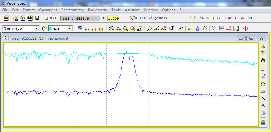

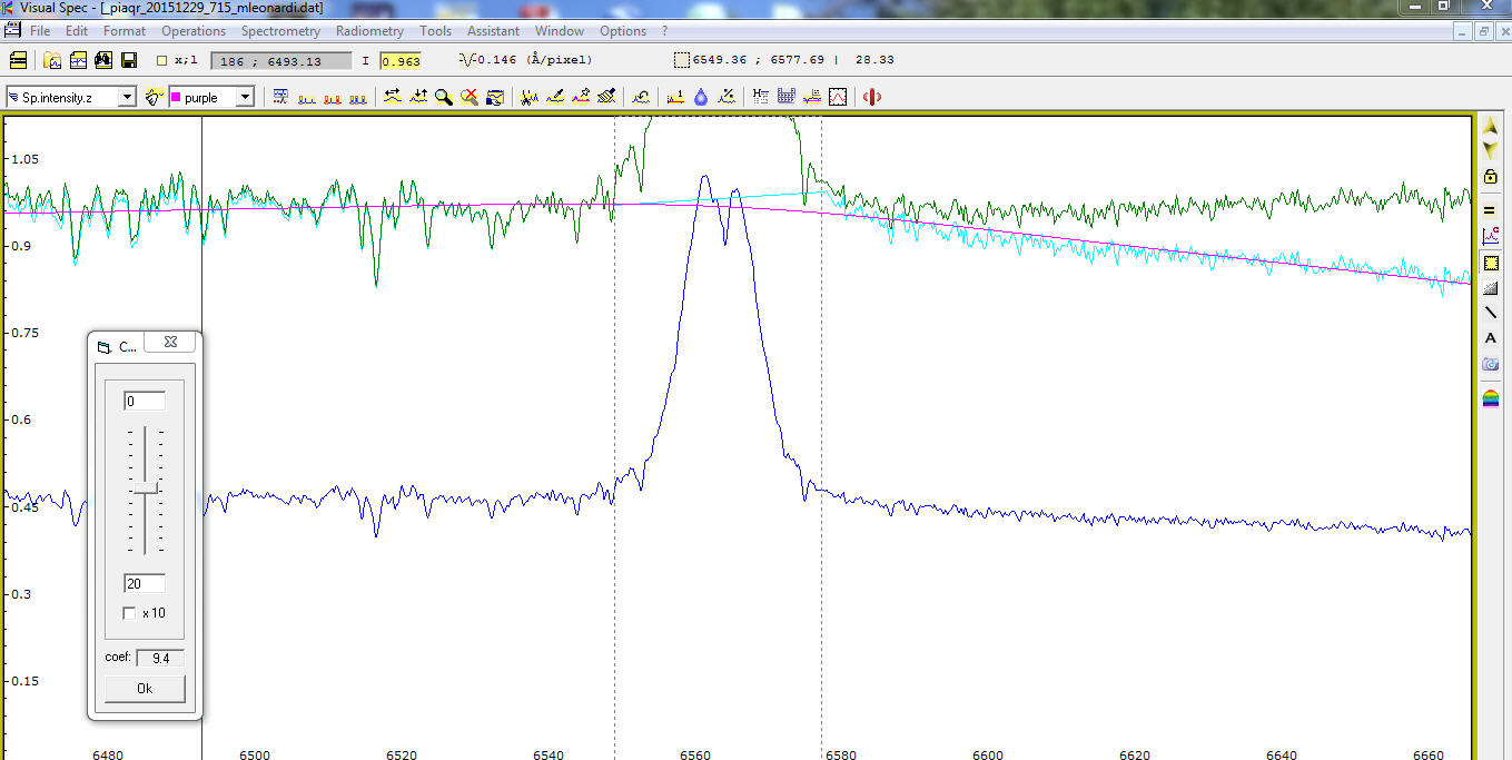

a very elegant way is to use the "Spline filter" function in VSpec.
I eliminated in your pi Aqr spectrum at first with the function "Supress Zone" the entire profile of the Halpha emission for that process.
Then I used in that "pseudo-continuum" the "Spline filter" function in order to find a "reasonable smoothed continuum" (see the following picture). Finaly I divided the original spectrum by this "smoothed continuum" to get the normalized spectrum. That´s all.
Best wishes, Ernst

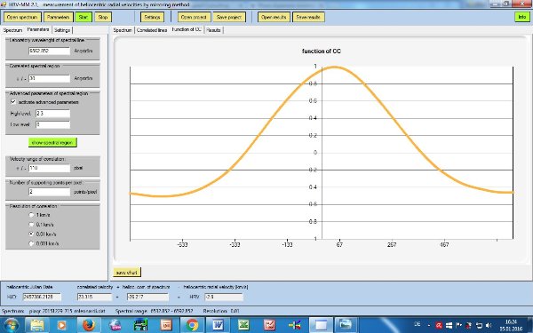

Dear Ernst,

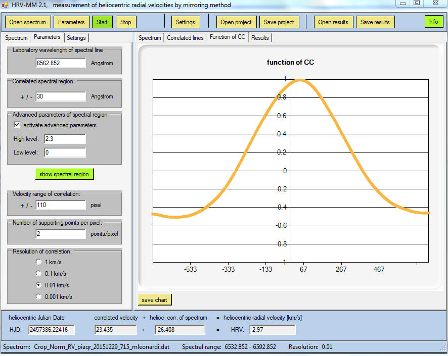

here we go ! I have followed your suggestions and I got an RV of -2.9 km/sec. Here below some images.
suppress-zone
spline-filter
HRV- MM show spectral region
HRV MM Function of CC
As Laboratory wavelenght I used 6562.852 Amgstroms.
Thanks again !
Marco
suppress-zone
spline-filter
Thanks again !
Marco

Dear Marco,
-2.9 km/s is exactly what I measured too.
Now it could be interesting to see, what the ephemeries of the paper of Bjorkman et al. (ApJ, 824, 2000) says.
Related to these ephemeries, you took your spectrum at orbital phase 0.512.
The RV diagrams at page 820 shows that at this phase we should expect a RV between (approx.) 0 to 10 km/s (the Halpha absorption during the B phase of pi Aqr).
Since we are not able to observe the traveling emission component, whose RV is also shown in the diagram, we can compare our RV only with this Halpha absorption.
But Bjorkman et al. observed the star during its quasi-normal B phase, what means that we don´t have any possibilities at all, to compare the RV of our disk emission.
But I think, the RV of the Halpha absorption during the B phase of the star, can´t be far from the RV of the disk. Particularly because the disk is relatively small at the moment (as our EW monitoring shows).
Best wishes,
Ernst
