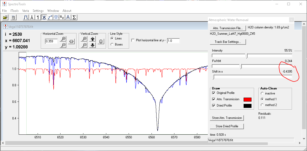

Hello Etienne,
I looked at your spectra and checked for wavelength errors. Both Regulus and Shelyak are ok, Vega seems to be offset by 0.4 A. For the analysis I used SpectroTools by Peter Schlatter, which is very convenient for this (http://www.peterschlatter.ch/SpectroTools/.
Vega calibration H2O.PNG (52.9 KiB) Viewed 9539 times
The calibration is automatic and very fast, I only see an offset. Check if we are looking at the same spectrum, downloaded from http://p5.storage.canalblog.com/59/09/7 ... 737878.fit
Best regards, Martin
Re: Vega, Sheliak, Regulus LhiresIII
Bonjour Martin,
Merci pour tes conseils, pour Véga effectivement je l'ai corrigé de la vitesse radiale, le spectre était un peu décalé par rapport au spectre ELODIE alors je l'ai déplacé de 0.45A pour qu'il tombe comme l'autre, et c'est la valeur que tu retrouves. Ais-je raison de l'avoir décalé ?
Martin Dubs
Posts: 144
Post by Martin Dubs »
Hello Etienne,
the spectra in Elodie are not heliocentric corrected as far as I know (You should check in their fits-header). The shift may be as large as +/- 15 km/sec for a galactic latitude of approx. 60°). So the correct procedure would be then to dry the spectra and then apply the heliocentric correction to both Elodie and your spectrum before comparing them. (0.45A correspond to about 20km/sec, which is possible, depending on the observation time)
Regards, Martin
