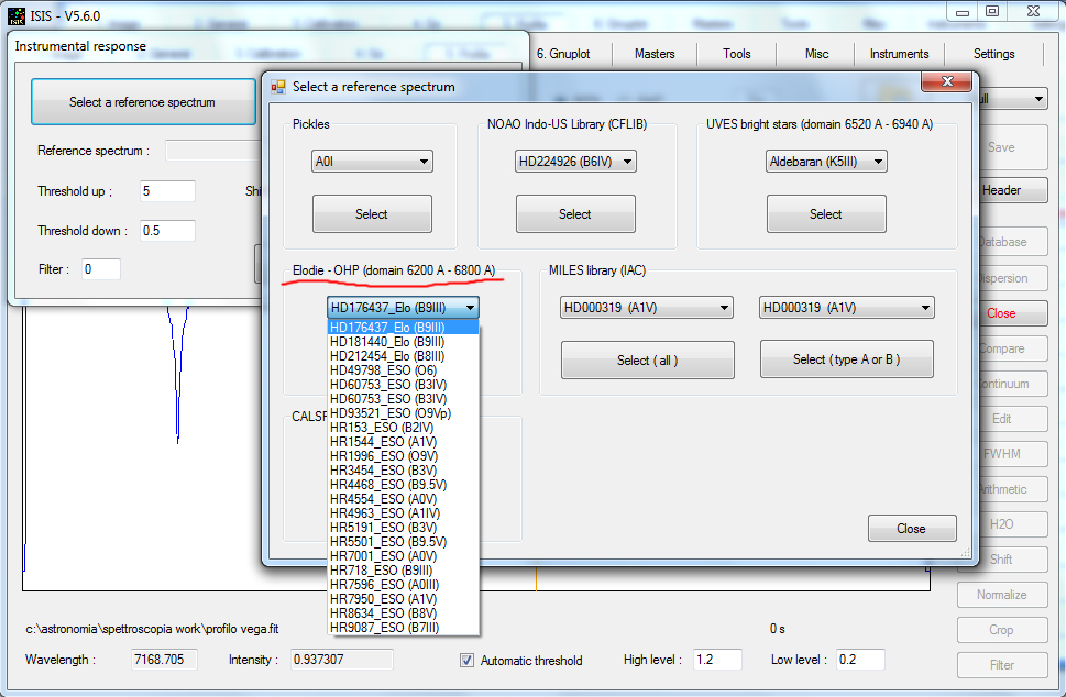

Hi Christian,
I updated to ISIS V5.6 at the weekend and just tried processing my first spectrum. Everything was working fine until I tried selecting a reference star for the response correction. The old "Elodie - OHP" drop down list and select button were present, but the drop down list was empty. Is this intentional or a bug?
The other drop down list boxes have values, though I noted then when I tried to select Vega from the CALSPEC list it gave an error message.
I backed out to ISIS V5.5.2 and the Elodie spectra list was again populated.

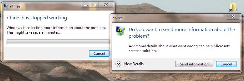

You have got further than me. I just installed 5.6.0 and it will not even run. (Windows 7 64 bit). It did however remove all my configuration settings from the version 5.5.1 I was currently using :-(

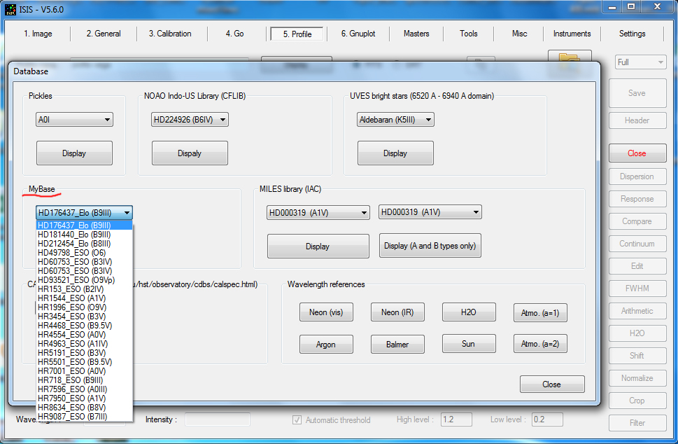

Hi Andy, Robin,
I hope that I have correctly understood the question. Christian gave us the chance to customise the spectral database with new library profiles as requested by Robin. Details are on release notes: http://www.astrosurf.com/buil/isis/new/release.html
The field we're talking about appears empty at first but if you add your personal list as indicated, ISIS shows the related star names. My current setup seen from "Database" function:
The only small bug I see on my installation is the label name on the form called from "Response" function (instead of Database). It still shows the old label "Elodie - OHP (domain...)" and not "MyBase". But functionality is correct:

Hi Paolo, Andy,
I cannot really help as I cannot get ISIS 5.6 to run at all. I just get this message

Maybe I misunderstood. I thought the 'mybase' would be in addition to the existing spectra including the old "ELODIE - OHP" spectra. Has the ability to access the "ELODIE - OHP" spectra been removed due to the problem discussed earlier in this thread with the Vega spectrum?

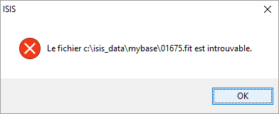

I've successfully downloaded ELODIE 3.1 and setup a mybase with the 3 Vega spectra (HD 172167) (01675.fits, 01676.fits and 01677.fits). I can plot them via the new Database button, but when I try to select them to use in a response calculation I get the below error message.
Error message
Error message
This makes me wonder whether I am missing something or if there is a bug.

Hi Andy,
I suspect a possible problem with the FITS extension. Normally if you select the .FIT extension
in the ISIS setup, the software can read the .FITS files of ELODIE 3.1 data base. You confirm: from the
Database button you can download the ELODIE 3.1 spectra ?
The problem is perhaps localized at the automatic radiometric calibration function level. I investigate.
But a VERY IMPORTANT point , I do not recommend to use ELODIE 3.1 from this calibration calibration tools
because the spectra are in absolute flux. A manual division of your target spectral profile
by a Elodie 3.1 spectrum --- after unity normalisation --- is preferred.

I confirm when using the database button I can download and display spectra. It was only in the Response then Select a Reference Spectra buttons where I was having a problem.
I was able to access the old "ELODIE - OHP" spectra by resaving them as ".fit" files in mybase and creating entries in the ".lst" files. So this gives me a way to use those spectra for response calibration. I think this could be a tricky step for new users though, so I don't know how easy it would be to add back the "ELODIE - OHP" button, or another set of high resolution spectra for use with the LHIRES III in due course. Though I may be missing something and there is an easy way I've missed!
