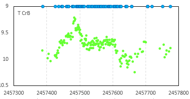

T CrB is one the few (4) recurrent symbiotic nova (1866-1946)
A new nova outburst is expected in the next months/years
T CrB produced a visual outburst at mag V ~ 9.2 in 2016
We have a good coverage of the event with 124 spectra in 2015-2016
Further observations are strongly encouraged at the better cadency as possible (T CrB is also one of the few symbiotics flickering at a short time scale)
