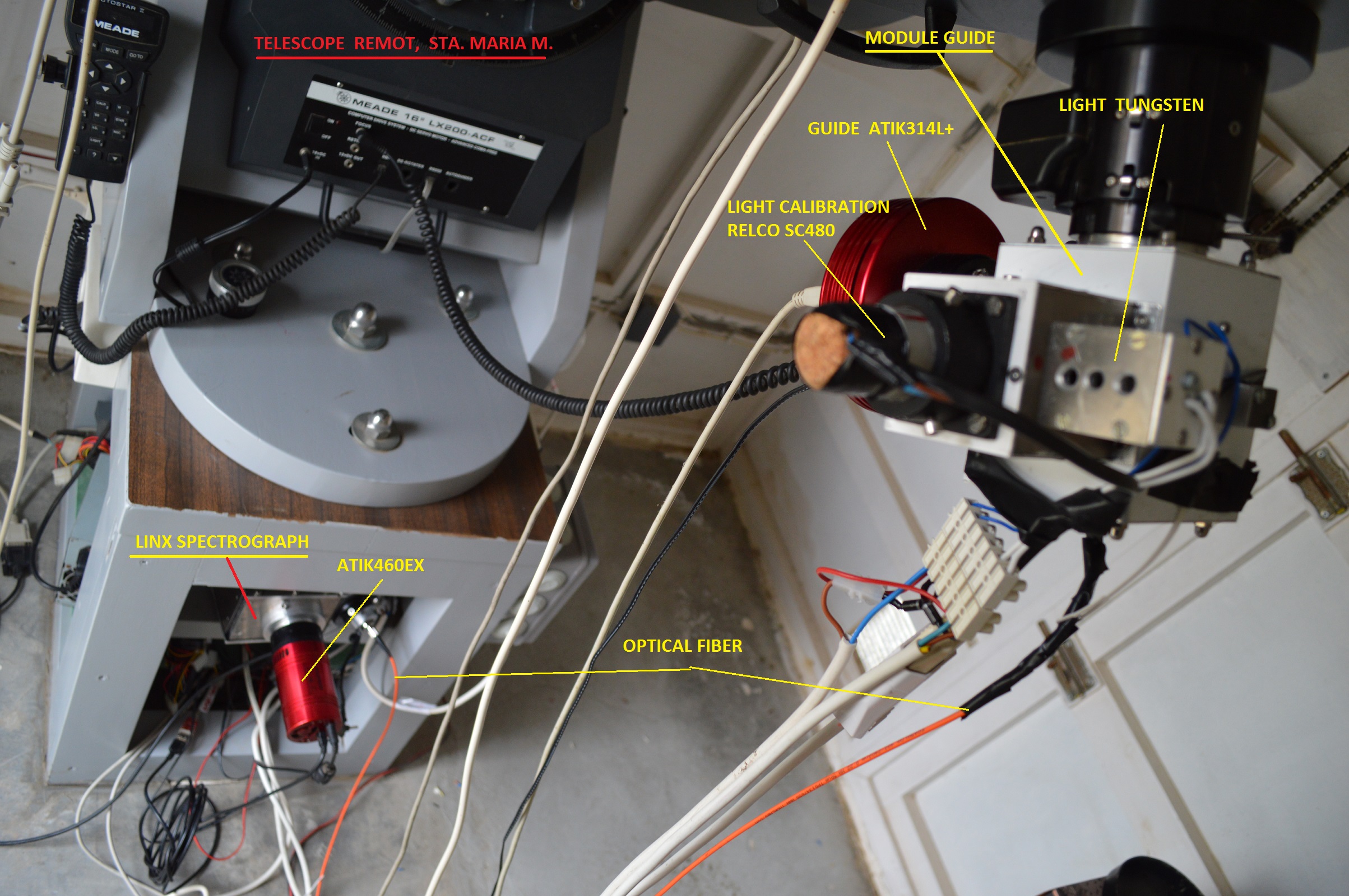

Bonjour Etienne,
These are both fotos of the LINX in the REMOT to Sta. Maria M.
Bien cordialement, Joan.
