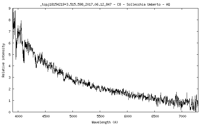

Re: Transient in Lyra

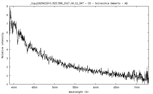

Post by umberto sollecchia »
Bonjour à tous, placez un nouveau profil de la nova, observé hier soir.
Profilo nova.png (8.74 KiB) Viewed 9903 times

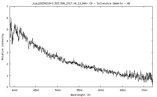

Bonjour, placé le profil d'observation de cette nuit.
Profilo nova.png (5.3 KiB) Viewed 9842 times

Well done Umberto. I also observed the DN on June 12. An important rebrightening helped us to continue the observations. Rebrightenings are also indicators of the WZ Sge membership (but there was no doubt considering the high amplitude outburst).
I performed a relatively long session to try and follow with photometry the small flux oscillations (superhumps) typical of this class stars. I covered about two cycles.
The DN lightcurve (SXV-H9, Mak 90 scope, V band filter Baader, 88 x 120s frames):
The flux oscillates about 0.07 mag around mean value 12.49. I used the latter value to calibrate the spectrum in absolute flux. On the top of graph I reported the spectroscopic coverage (11 x 960s frames).
In addition to h-beta and h-gamma, the profile show the He I 4471 broad absorption line.
