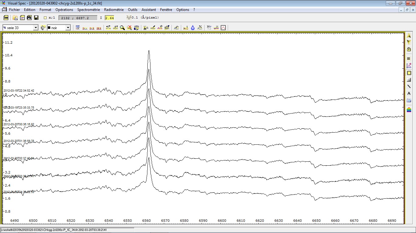

i had an opportunity to a all night session on CH cyg during the 19-20 March. 7H of observations. I had also a spectacular solar spectrum at the end...not includes in the CH cyg series of course.
Ha alpha as seen during the last 40H of observation shows small hourly (time resolution) variations of the blue peak. This is not due to tellurics and must be real. I localized a second sky emission line at 5661A. Both 5551A and 5561 are sensible to the height of the star above the horizon or bad guiding (letting sky background enter the fiber).

H alpha variation during the night

New comments from Margarita:
"Hi Thierry,
Again, very interesting, especially the changes of Halpha.
Halpha may be coming from some region of the accretion disk and perhaps varies as the high speed photometry shows at scales from few minutes to hours.
We've observed a quasi-period of ~500s in U an B. It would be good if one can get shorther exposure of the Halpha region (inspite of the lower S/N to see if there is a variation on 10 minutes sclale?
Thank you,
Margarita"
So it could help Margarita observations to make CONTINUOUS high resolution spectra in Ha with a 600s max exposure cadence despite lowering SNR.
