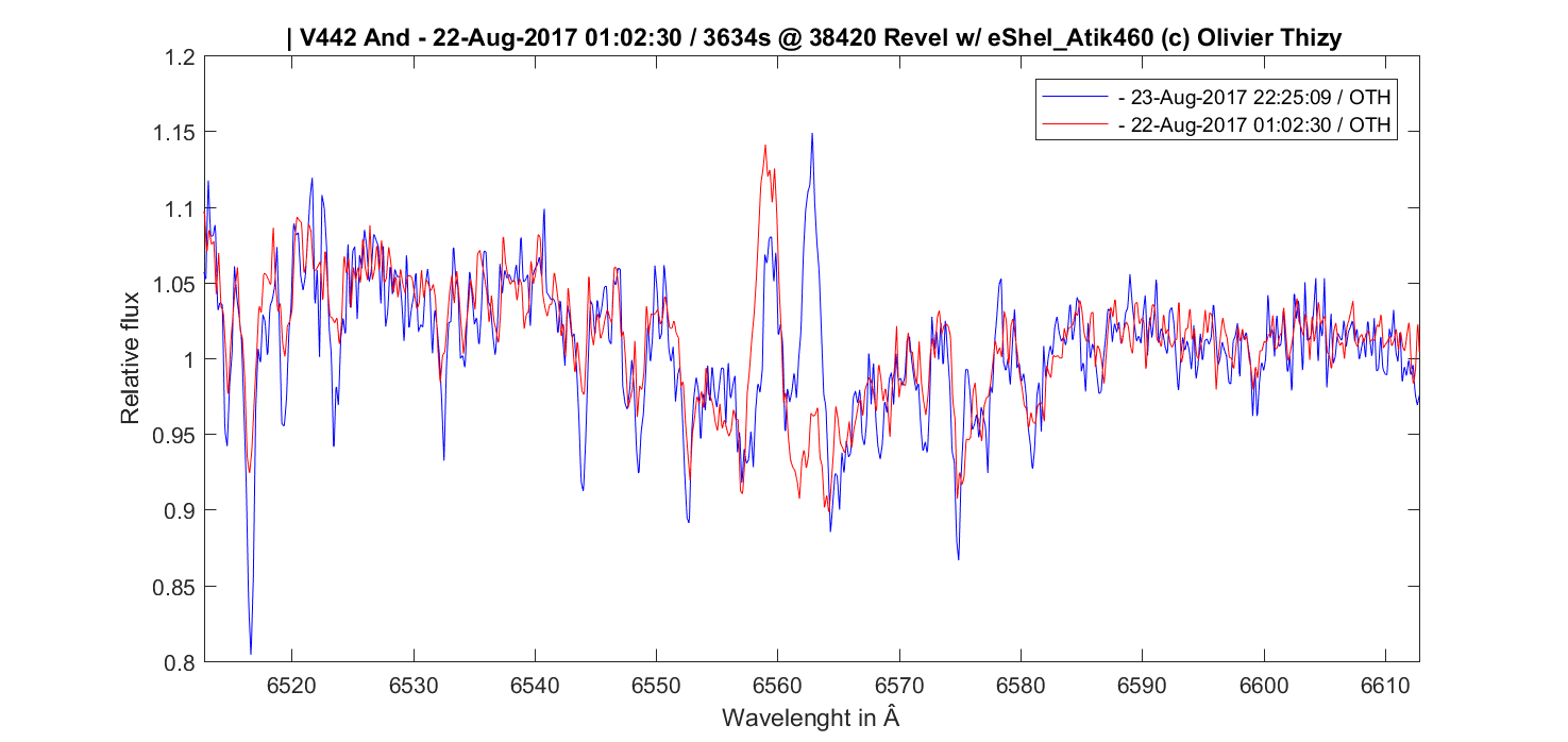

The V peak is now higher than the R peak, change took place during the last 24hours:
I did three 1hr runs on V442 And tonight but no change is clearly visible:
Hum... interesting....

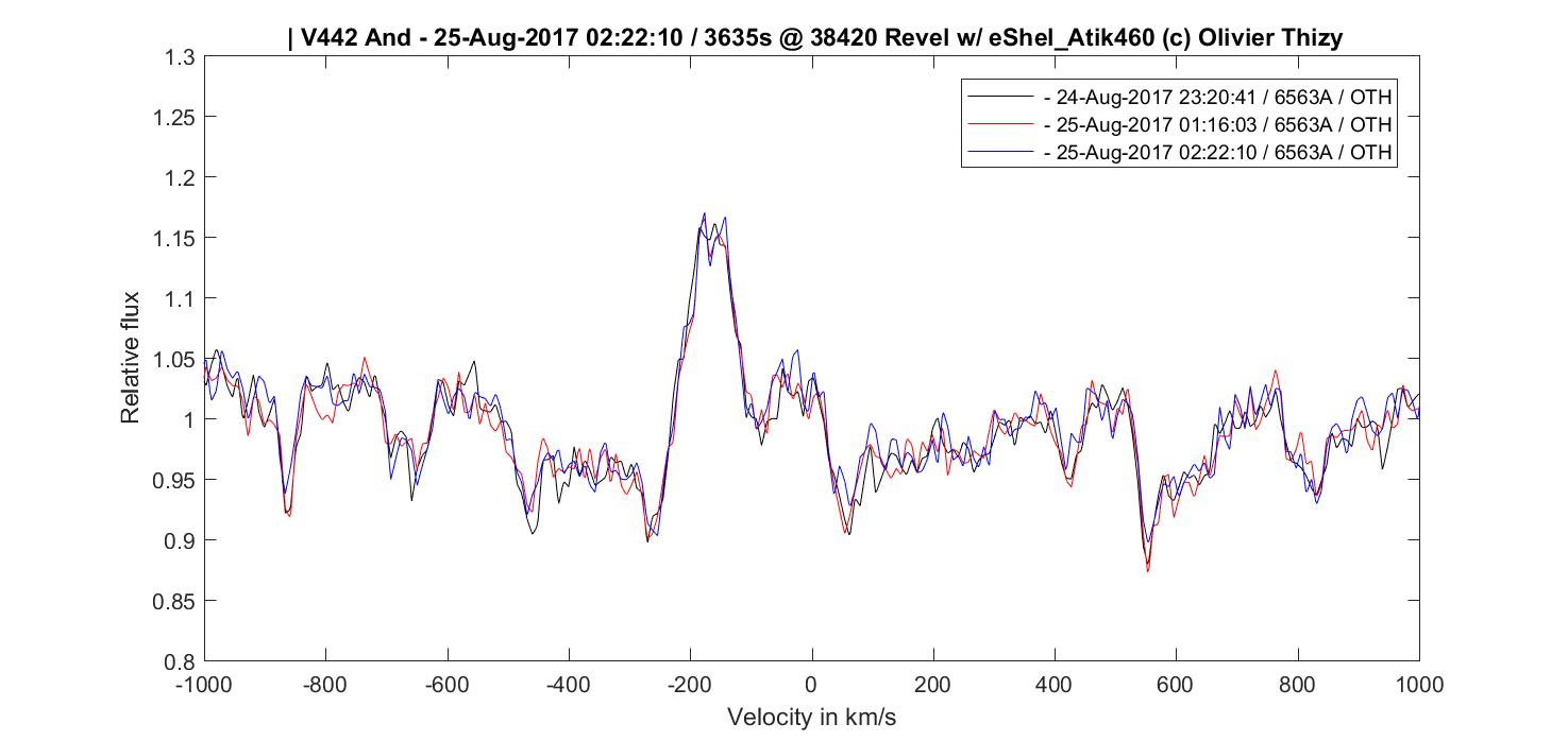

after a 6h monitoring on V442 And, I think I notice a small increase of the V peak on the first hour and a decrease of the R peak on the last two hours:
I do not think this is my imagination nor noise... or is it? :-)
