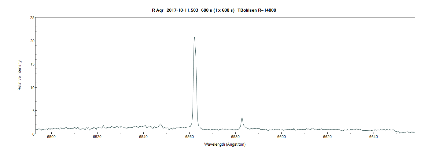

Terry Bohlsen
Posts: 191
Re: R Aqr spectra requested by Margarita Korovska
Post by Terry Bohlsen »
From last night (11/10/2017) Australia time
B=11.44
V=10.07
Spectra of Ha region R=14000
Terry Bohlsen
Armidale NSW
Australia
