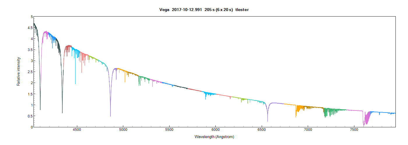

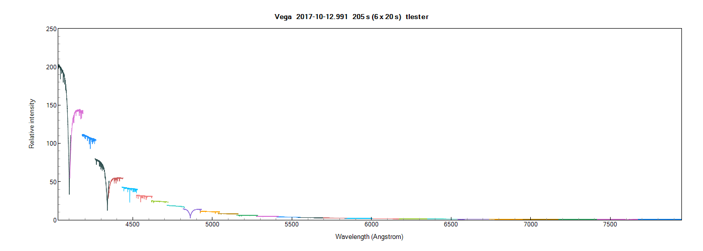

- Posts: 1432
Re: ISIS V5.9.2
Tim,
I tested ISIS V5.9.2 with your own data and I get a good result by selecting the "per order" option and by selecting "Order merging adjustment" (simultaneous action). See the eShel dialog box:
Here's the result :
It is important to select "Order merging adjustment" when using a response "per order", because the response files do not have a normalization relation between them.
And so, if you do not select "Order merging adjustment" you actually get this effect:
To be able to deselect "Order merging adjustment" option it is mandatory to work with a global response file (not per order). It makes sense (but I admit, it requires some explanation).
Note that today, I prefer this global method, more expeditive. The procedure is simple and standard:
- First step - I normally process the spectrum of a reference star, but without providing the name of the response file (at this point, you can select or not "Order merging adjustment", this has no very significant effect).
- Second step - I calculate the response file by dividing the spectrum obtained at the first step by the theoretical spectrum of the reference star.
- Third step - I normally process the science spectra with the global response file found. Here you can select or deselect the "Order merging adjustment" option without any problem, depending on your needs.
You arrive at a correct result now (per order + Order merging selected) ?
Here's the result :
